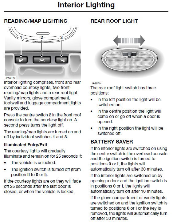

The Owner's Handbook does not indicate how to turn-off this feature.
Attached Thumbnails Question about interior lights and auto door unlock.-interior-lighting.png
