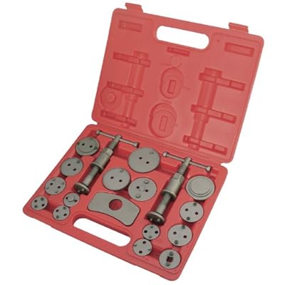

I bought
tool (clickable link). The cube thingie is cheap and easy enough, but having ended up with it stabbed in my palm a few times, a few skinned knuckles, etc - I just decided to get the right tool.
$35 USD, and it seems like an adequate tool. Build, materials and fit seems fine. Plus, enough goodies to fit just about any other vehicle, too

Also the brake piston cube tool is available at any auto parts house or Sears or Harbour Freight store etc. for around $10. The compression tool is not needed for the rear brakes but is needed for the front on these cars.

I bought

I too have this tool..i borrowed it from autozone but im having difficulty using it and would like to know how you were able to use it.
I was using both the E & F adapters with the push assembly and back plate..i held the 22mm hex screw while trying to turn counterclockwise (rear driver side - i heard it is supposed to be counterclockwise and rear passenger is clockwise)
However following all directions i still was unable to retract the piston. I even tried a smaller adapter (i think G) and still no results.
Could it be that my caliper is permanently stuck or im not using this tool right??
Also..when i removed the pads..they were stuck to the caliper..they did not rest on the caliper carrier (which i imagine is where they are supposed to be housed). I was concerned because i had to use a rubber mallet to remove the pads from the caliper because it was clamped to the piston.
Any help is really appreciated!!
droid, when winding in the rear calipers, open the vent port on the calipers and then try doing the pistons. A lot of people have found that unless you are the Hulk, you will not be able to push in the pistons unless you open the bleed port. Then they will go in really easy. Just be ready to catch a little bit of fluid.
As for the pads being stuck to the calipers, it is possible that someone glued the pads. This is done to minimize the chance of any pad noise. I do it to my car all the time. Granted, the stuff I use isn't that hard to remove, unlike what you are experiencing.

Thanks Thermo..you are always always so helpful in your guidance..I will try your recommendation as soon as this blizzard lets up.
I'm just concerned that my caliper is completely shot because the rotors were paper thin!!..and my best guess was that the piston was permanently stuck..which I hope that is not the case.
But I never tried opening the bleed port and I will try that next. However, can this cause air to be introduced into the brake lines and will I have to add brake fluid after I'm done?
Droid, 2 things with the condition that you are in:
1) because the rotors were so thin, it may be that the piston got unwound too far and it has actually come "unscrewed" (if you ever take a caliper apart, you will get what I am saying with this, but there is a screw mechanism which is what you are rewinding in this case). So, you may need to make sure that you push the piston back on square so you can mate the threads back up and get it properly rewound.
2) yes, most likely you will need to bleed the rear brakes after you are done to make sure that you get all the air out of the caliper. But, this is pretty easy to do. All I do is get some tygon tubing (9/32" inside diameter as I recall) and run it from the bleed port to the top of the wheel well and back to a glass container on the ground. You can then open the port, pump the brakes a few times to get a standing column of fluid in the tubing. Add some more fluid to the brake reservoir, pump it a few more times till you see the fluid change color. This will garantee you have new fluid in the caliper (maximizes life) and that your caliper if full of fluid with no air in it. You then can close the bleed port and move on to the next wheel.
The big thing with the bleeding of the brakes is making sure that you don't drain the fluid reservoir. I normally pump the brakes 4-5 times before I add more. Having a second person with you when you do this can be helpful.
