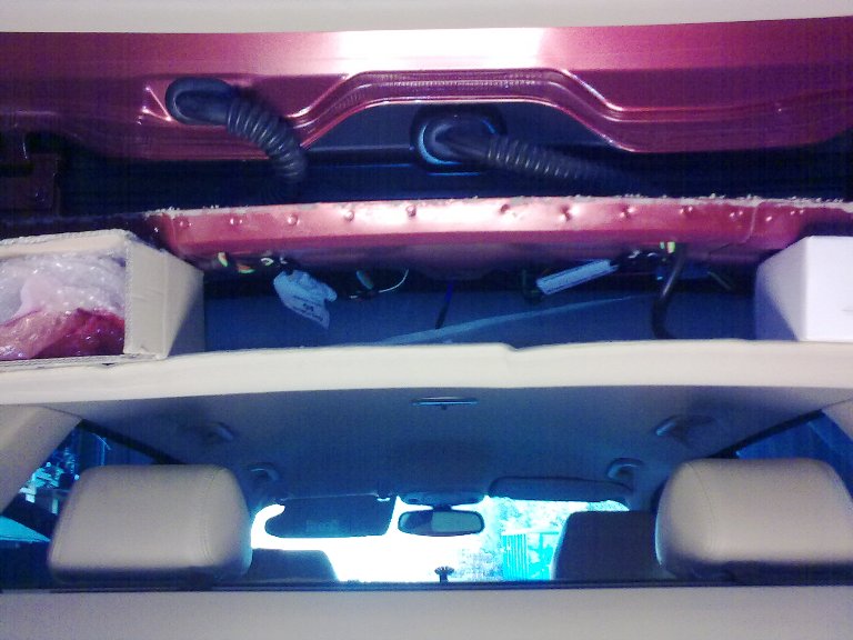

Default Signal booster
In the estate you can find a signal booster in the antennas base.
You have to remove some seals, plastic cover of the rear pillars and then you can pull the head liner down a little.
Replacing the signal booster has done the trick to some X-Types. Don´t have the parts number though..
Attached Thumbnails  Radio Reception poor-antenninjalka.jpg    Radio Reception poor-verhoilu.jpg

Default 2005 Estate Antenna
My FM/AM was never great in the 2005 estate wagon but about a month or 2 ago it got much worse and I usually only get one station to come in, everything else just static. I checked all the connections at the antenna (roof mount) and at the radio(w/ navigation) but all appears tight. I went to locate the AM/FM amplifier module which according to the workshop manual should be near the right c pillar but after removing the c-pillar trim and levering down the headliner I do not see anything that resembles the amp depicted in the workshop manual. The picture of the amp in the message above looks like it might be attached to the antenna base. Since this is usually my wife's daily diver, I need to get it fixed pretty quickly now. Any advise would be appreciated.
Thanks David N

Yep, replaced the antenna base C2S34571 and all is good! I opened the old antenna base and there was lots of corrosion, some how moisture got in and caused some havoc.
