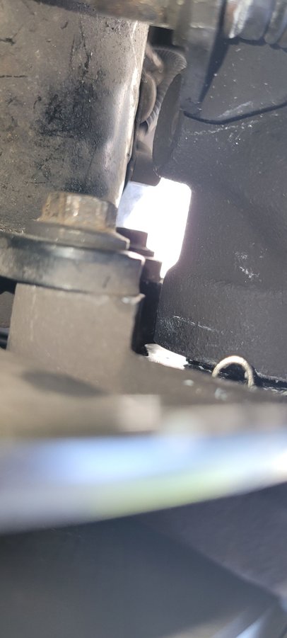

@Thermo @Peter_of_Australia so I think I did what you said and no luck the pin is in the slot with the piston and the handbrake does push the caliper but the brakes do not and it still goes to the floorThese might help you see what I am seeing:
you can see the pin that's on the caliper but not that clearly.

@ HELP: So to confirm again: You do have an electric handbrake, yes? That is one, which activates automatically, when you put the car in P and pull the ignition key.
It's a mystery to me. The most likely thing would be a blockage in the hydraulic hose to THAT caliper (I hope, the hose is connected to the caliper.)
I would remove that caliper form the car completely and clean it (after removing the piston), and of course re-assemble it with the new rubber-seals, which you should have received in the mail by now, if you ordered them.
