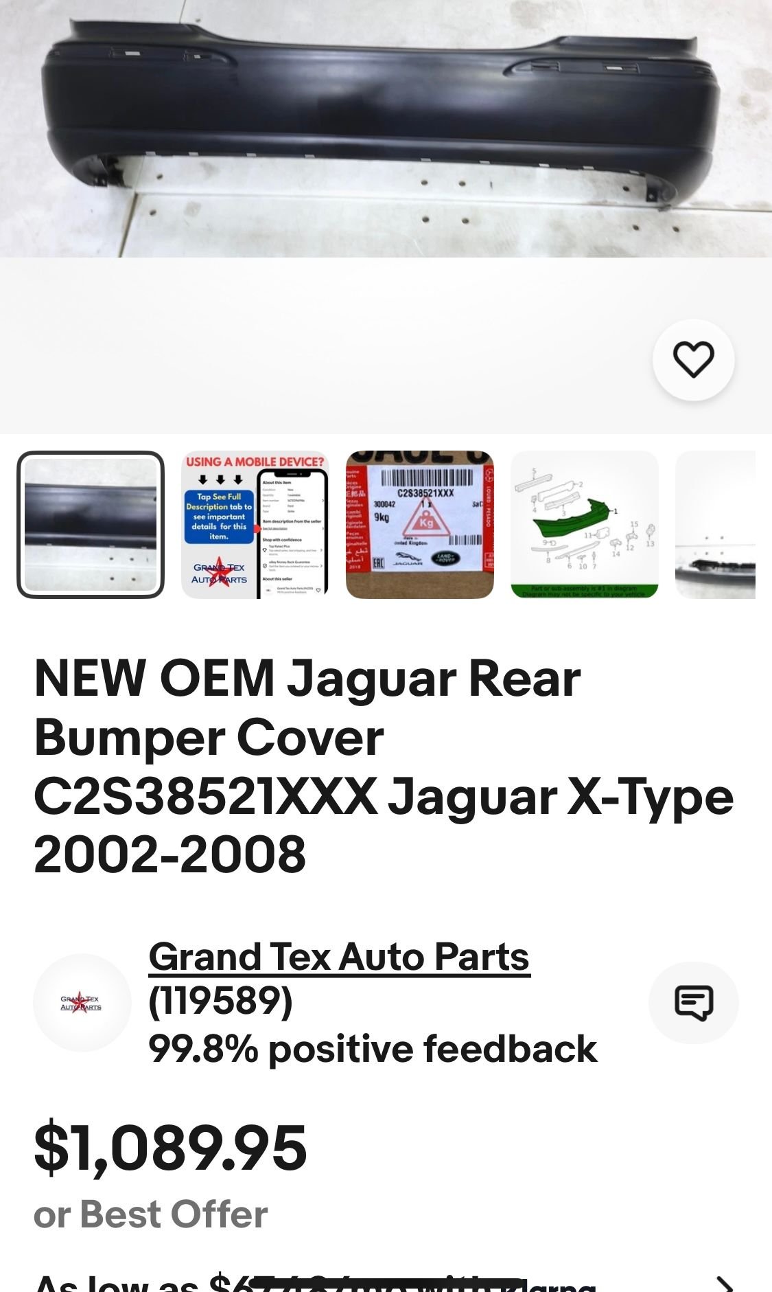

this suggests that yes it does, the fact that a geniune oem ebay listing includes all years, but you should find further evidence as this is not 100% proof
