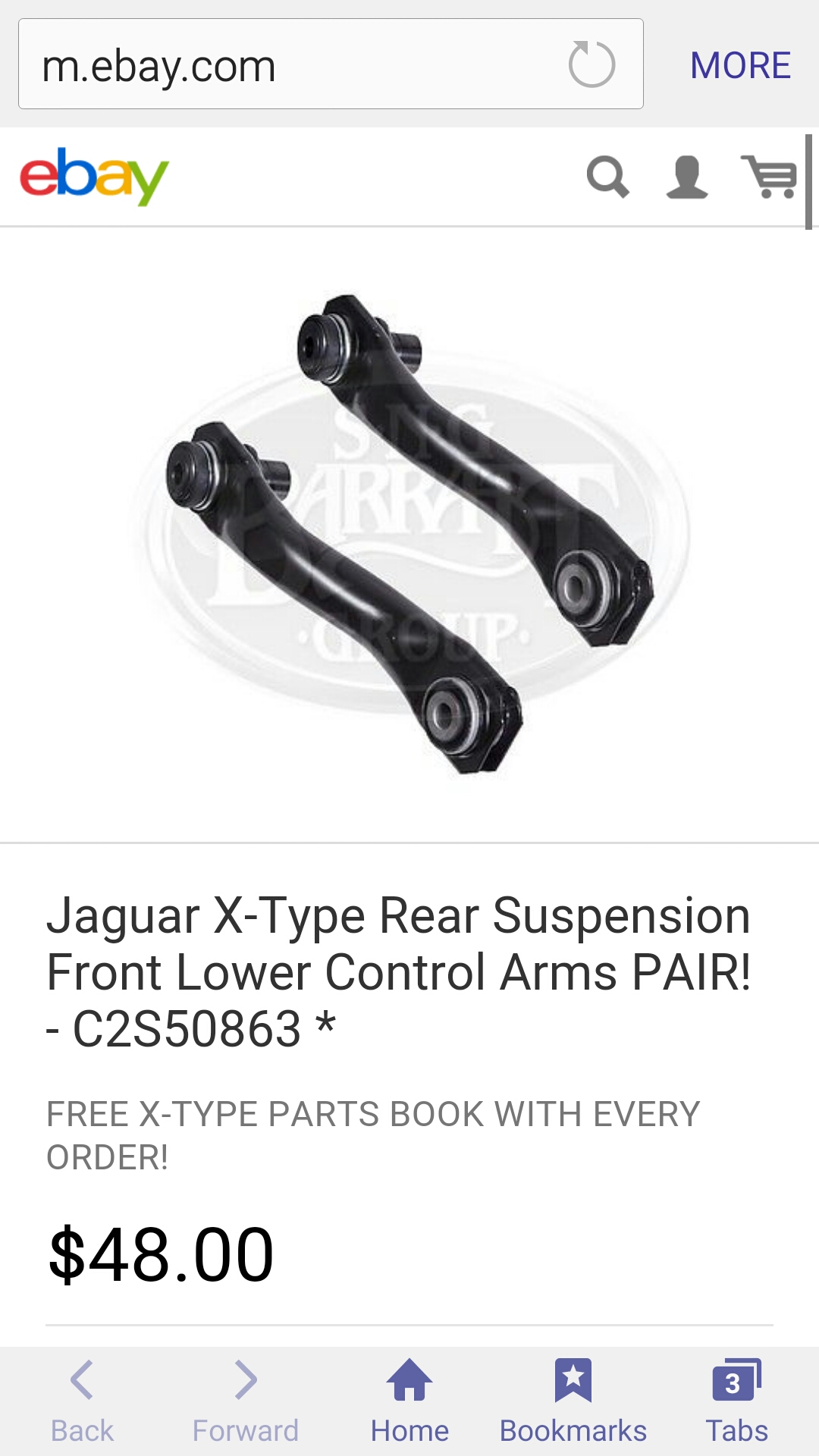

Going to order/replace both sides, is the car weight pressure on these necessitating support of wheel or suspension before removing, or can I just unbolt and rebolt new ones in?

I jacked up one side at a time, removed wheel to allow access and get enough leverage to break the bolts free. I had to heat the nuts to release the loc-tite or they would have never come out. The large sleeve on one side had become completely free and spun within the arm, the loc-tite prevented the bolt from coming out and I had to cut it off.

Dell, no need to do a complete disassembly of the rear suspension. Undo the two bolts and the arm will come out. May take a little bit of effort to get the spindle back to the correct spot, but a little push with your hands should be all that is needed.
Like was mentioned, the bolts may not play at first. Make sure to use a good penetrating fluid and have a good breaker bar handy.

Thx, seen a video of the jacking it up procedure, but I'm running it over to Hill Air Force Base "Car hobby" facility to use a hoist. Didn't know if constant vehicle weight would change the removal. They let you use facility, hoist, any tools including impact for $6.50 US/hour. Well worth joining the club there. Lubed the living daylights out of it, while finding the body motion sqeaking with Fluid Film, so it should be well "penetrated" by the time I get ready to replace them. Shop manager said he had never heard one squeak that loud before (moving the body up & down with the sway bar).The rubber bushing are crumbling apart, they're so dry.
