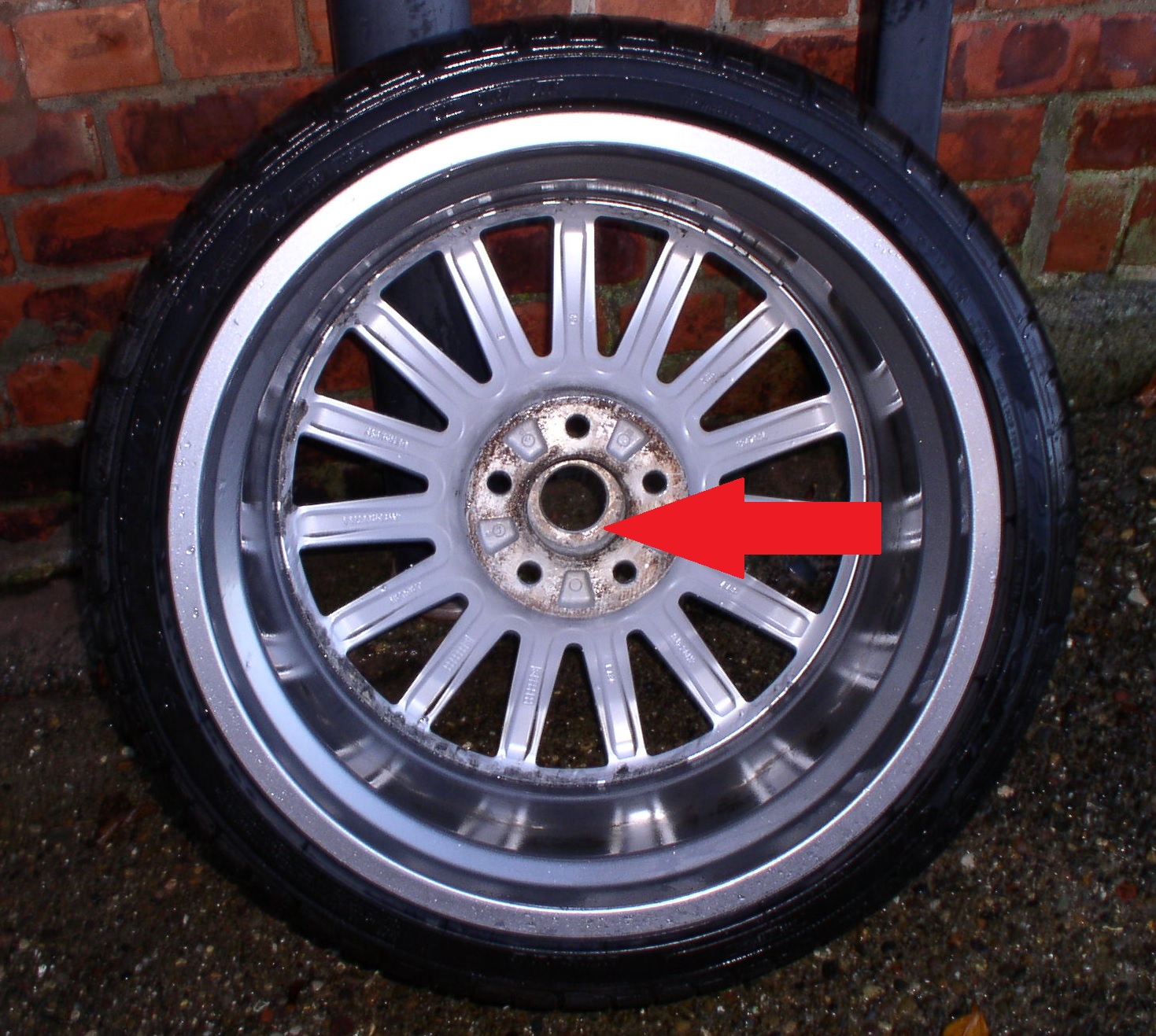

Stu,
Did you thoroughly clean the wheel centres before fitting the new caps?
The perimeter of the hole in the wheel centre and the back of it (arrowed) are impossible to clean properly without removing the wheels.
Admin Jim recently recommended Sonax Xtreme wheel cleaner to me and it's fantastic stuff for easily removing all traces of dirt without damaging the clearcoat.
Encrusted road dirt here prevents the cap from pressing in easily and risks breaking one of the four plastic lugs.
A properly fitted cap in a clean wheel should rotate quite easily but be firmly held in place by the lugs.
Too late to help this time but you'll know in future!
Your X-Type is looking good.
