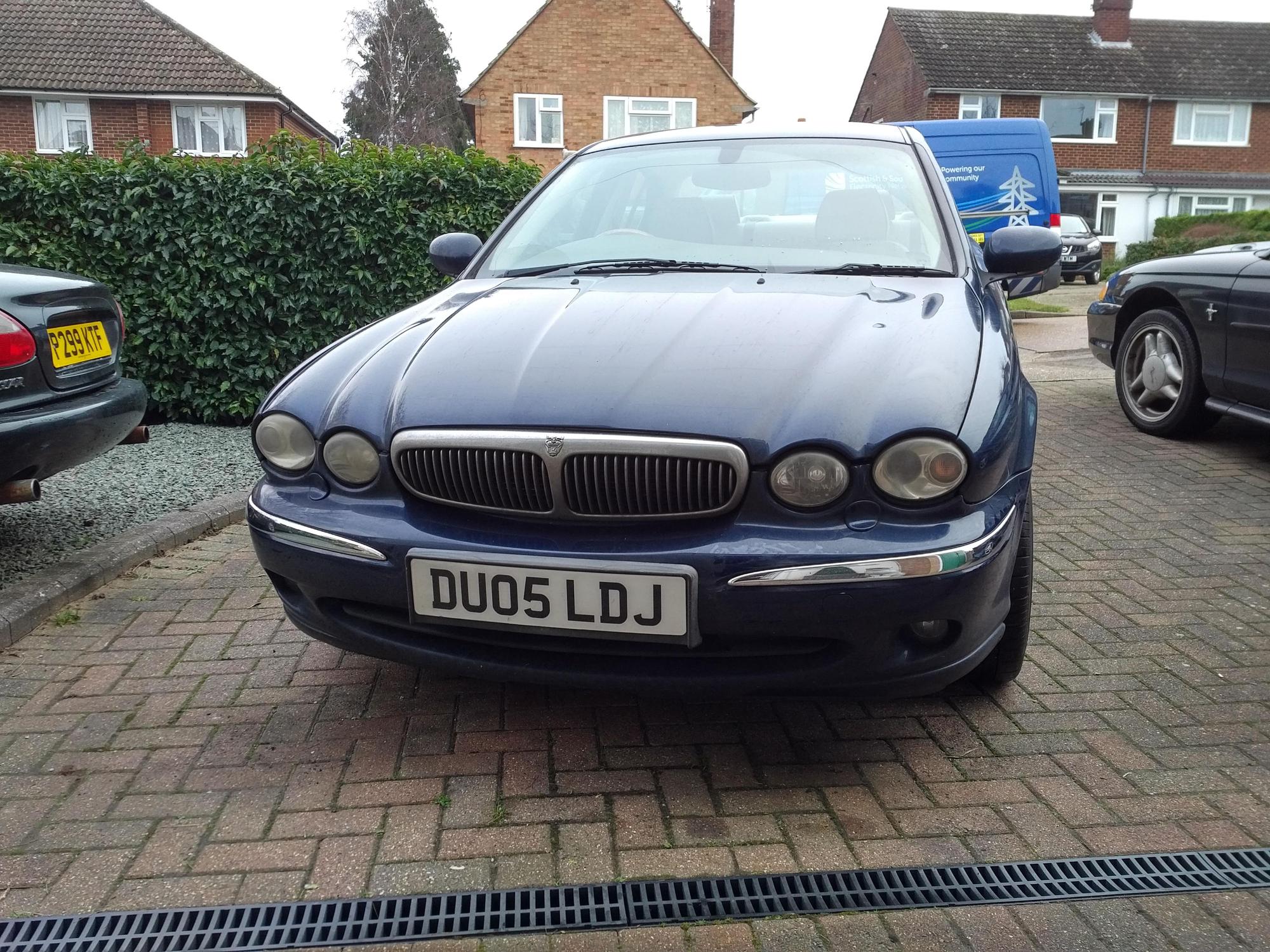

Well, I managed to get them off. From the wheel arch I was able to unclip the initial holder then, as said, pry them off. A couple of challenges were found that the passenger side one had been screwed on and the heads were mashed but I just drilled them through. Then some brute force and arrogance on the rest (and a hammer and screwdriver...).
Took about half an hour to get them off then 5 minutes to get the new chrome ones on.
Much better now I think.
And then another slight modification was done...
Now he looks like a Jaguar should...
