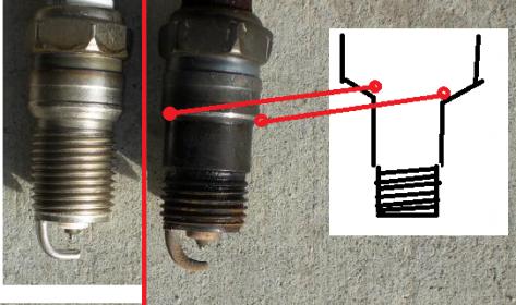

That's an awesome write-up, thanks. Those spark plugs are different thought, with different thread lengths. Are these correct?
Yes, these are the suggested double-platinum replacement plugs. Overall depth from the seal area/ridge to the ignition point is the same from what I measured, so you should still have great performance with the new plug. My X-type is running great.

great write up with the pics I enjoy reading about good fixes. Thanks.I did my plugs the second time in 1/2 the time as the first. Question; what was the deal with the different length threads on the plugs?

You guys are all dying to know about the threads on these plugs In essence, what is going on is the following if you look at the pic below:
The original plugs are OEM so they are threaded in line with the actual threading in the spark plug receptacle. As the replacement plugs are not Jaguar only plugs, the threads are longer to accomodate different engines. It still works great for the X-Type though, as you can see it still makes contact at the seal ridge and meets the same overall depth. The fact that some threads are not used doesn't matter in the end because the spark plug hole is wide enough at that point not to make contact.
Let me know if I didn't make enough sense yet, but rest assured that you will be ok using plugs like this.
