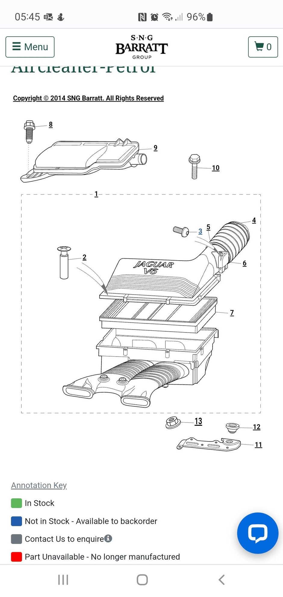

Thanks for your response H2o2, the exploded diagram calls it a mass air flow, however its definitely a 5 pin plug. No 6 below:Originally Posted by h2o2steam
