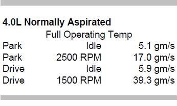

Just checked MAF readings, seems to be some 15-30% higher then indicated:
- Park, idle: 6.6~7.0 (should read 5.1)
- Park 2500rpm: 22.5 (should read 17.0)
- Drive idle: 7.3~7.5 (should read 5.9)
- Drive 1500rpm: 45 (should read 39.3)
Now there is plenty of info on lean running X308's, but running rich is much less documented.
Am I right to focus on a failing MAF sensor, or are there other things to check first?
