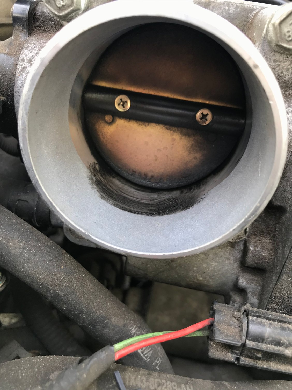

Hello, had a same issue.
Realized that there was a plug from the closer head (V6-2003 X Type) that was loose. (Metal pressed into the aluminum head of the engine)
basicly oil was splasning from engine into the upper chamber (under the black head cover) and made its way into the hose on the right.
From there it has filled the intake with oil resedue and made it all the wat to Throttle Body.
After only cleaning the throttle body car went from barely 500rpm to 900rpm.
Still a bit shaky but cleaning made a huge difference.
