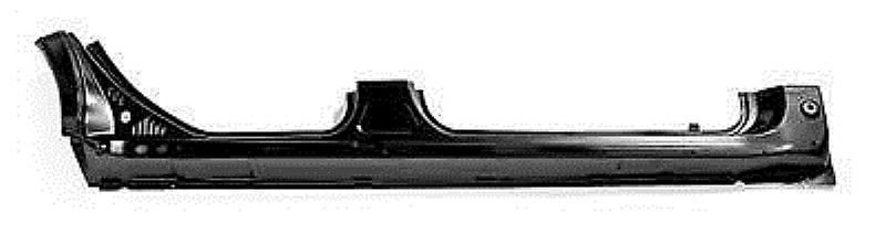

If you really want to keep it, these are pricey, but very useful (with shipping about $550!) Keep in mind that you can't really see the stuff, so judicious use of a torch and good sheet metal can get you far...
Remember that off-side is UK driver, or right-hand (passenger) here; near-side is our driver;s side in the US...
Jaguar X-Type 2001-2010 Sill Full Type Driver Off Right Side IMP | eBay
