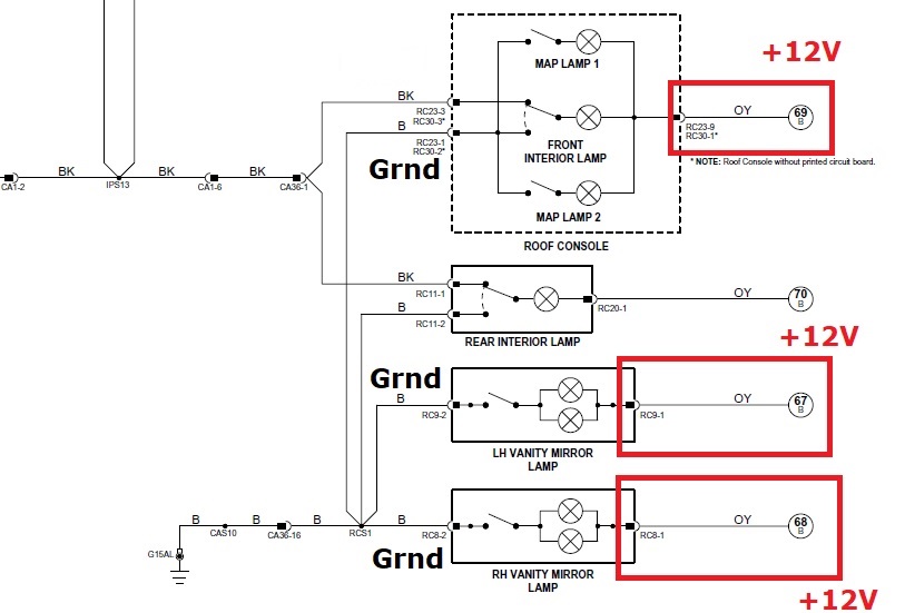

Dunks,
Are you thinking of adding an entirely new Sat/Nav component (Garmin, TomTom, etc) to your console in addition to the existing entertainment system, retrofitting your existing system with a used Jag Sat/Nav unit or replacing your existing entertainment system with an aftermarket one which has Sat/Nav included?
If you are adding a Garmin/TomTom, etc - you can grab +12V from the Orange-Yellow feed to the roof console or either vanity mirror Orange-Yellow feeds. You can ground using the Black wire on any of these locations also.
So many options, so few choices...
