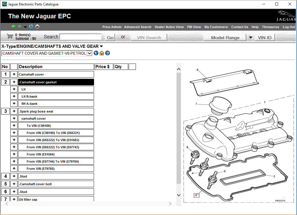

Wow. That plug looks awful. I have heard poor reviews of the E3 plus and would get rid of them. A double platinum plug will last 100,000 miles. The oil in the spark plug wells comes from failed cam cover gaskets (#3 in attached image). While doing that I would also replace #2 gasket also along with the IMT o-rings and the upper and lower intake manifold gaskets.
Here is a link showing how to get at the rear plugs. https://www.jaguarforums.com/forum/x...nge-faq-48128/
