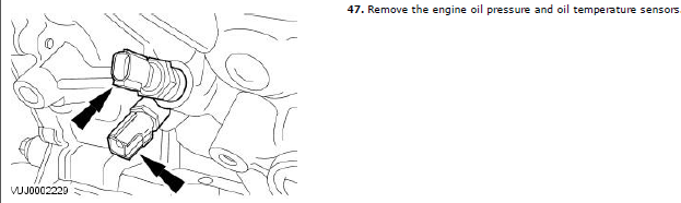

Trevor: Check the oil pressure and oil temperature sensors. They're behind and above the A/C compressor, to the left of the oil filter.
Picture from the Jaguar Motor Project: Jaguar Motor Project: May 2006
Attached Thumbnails She sprung an oil leak and I can't find it-jaguar-x-type-oil-temperature-pressure-sensor1.png   She sprung an oil leak and I can't find it-jaguar-x-type-oil-temperature-pressure-sensor2.png   She sprung an oil leak and I can't find it-jaguar-x-type-oil-temperature-pressure-sensor.png

Okay guys, not a fan of working on the x type so how the heck do I look at these things.

Trevor: Try elevating the front of the car, e.g., drive the front tires onto ramps, lie on your back under the front bumper and reach up next to the oil filter with your smart phone to snap pictures of the two sensors. If one is leaking oil, you'll see old black oil coated with road grime under the sensor. If necessary, remove the oil filter to give yourself some more room.
If you need more room, the next step is to loosen the serpentine belt, remove the 4 bolts holding the A/C compressor to the oil pan & block, and move the compressor just enough to access the sensors(without disconnecting any Freon lines). That's a bit more work, so hopefully removing the oil filter is sufficient.
If a sensor is leaking oil, you can try to tighten it, or replace it. When they leak, it's usually just slow seepage past the threads.
