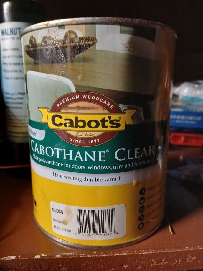

I found a bolt, which fits the thread of the knob, cut off the hex-head of that bolt, placed the bolt with the knob screwed on like a drill-bit in a drill (in my case a battery powered one). And then I simply held/pressed the sandpaper (starting from coarse to fine) on a sanding block onto the rotating knob until the old coating was off entirely.
Then you probably need to stain the resulting clean light-brown wooden knob a bit darker (walnut or teak stain) - or not. Let it try, and then apply clear PU gloss. I actually dipped the rotating knob on the drill into a can with PU, and then continue to let the knob rotate very slowly to get an even coating. The more time you put into this last step, the better the result.

I meant to continue to rotate slowly at occasional intervals. The idea being that the surface-coating of PU distributes evenly and the liquid PU does not accumulate at one point. Maybe a little bit of help from a heat gun may help.
