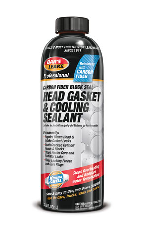

Now is about the only acceptable time to use a little "Better Living through Chemistry": Throw a bottle - or two - of Bar's Leak brand Head Gasket & Cooling System Stop-Leak into the cooling system.
It's about $60 USD per bottle, and most likely will fix the head gasket leak.
Personally, I would remove one end of the upper radiator hose and pour it in there, and then drive it for an hour at least. If you just pour it into the reservoir, it might simply settle to the bottom of the tank.
There are other chemical compounds out there also specifically for head gaskets, but the best of them require draining down the coolant, filling with the product and clear water only, and then draining down the water and adding coolant after it has sealed.
I am not a big fan of using Bar's Leak, but "in a pinch" I do use it, and it has never failed. The product shown here is a new version I have never used, but the $6 Cooling System type has yet to fail for me in the past. The coolant appearance may change to that of lumpless diarrhea, and when a "proper" fix is applied (ie: a new head gasket) the system will have to be power-flushed to rid it of the Barr's Leak.
Let the screaming at my post - by the "purists" - begin!
(But I say $60 and the car is fixed now beats $1,500 and you have to wait)

Bruce, this is one of those times that you are probably right in using the Bar's product. If things don't get any better, then you are not any worse off. I am not an advocate of using the stop leaks, but there are times where it does have benefits.

It's worth a try, the Bar's Leaks. The downside is the cleaning it out of there if it doesn't work and you end up replacing the head gasket. But that is a manageable drawback.
