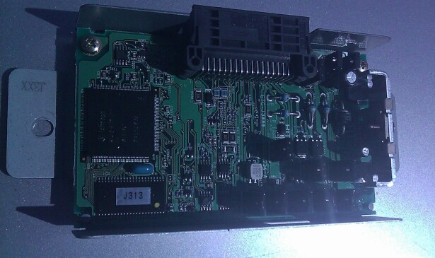

Do you think you could take a pic of the TCM and put it up?
Ive been looking for it for the past like week and still have nothing... i belive i found it though, but there is a little gray box mounted on top of it or something like that.
Charm,
You are correct, that is the TCM. My 2002 has a swinging latch to hold the connector in. It is tucked away in the dash, near the fuses. Below is a picture of the TCM with the cover taken off.

Sweet thanks Tpro123, you just answered my main question.
Thanks for the picture i really appreciate it.
