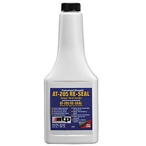

I agree with RudyF6 and AlfaVeloce - just drive it.
There are a lot of quality products that will help "renew" the seals. Most cost under $10 USD.
Try a can of
<i>this</i> this
"juice" in the crankcase:
If you read the reviews, and watch the ScottKilmer.com video mentioned in one of the first reviews, you'll probably agree it's worth a try at $9.99.
Non-petroleum, not just for trannies, purported to be non-snake oil.
(The "Old-Schoolers" here in the forum will remember when the "Better Living Through Chemistry" cure for the leaky valve seals was 1/2 quart of auto tranny fluid in the crankcase)
