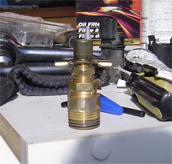

rjcl, take a look at this pic:
If you look at the pic, you have both pieces there together. The top is the radiator drain valve with the collar that you need. You shove the tygon tubing into that collar. The bottom piece, you can see where I have already ground off the hex for the fastener, is simply an adapter that has 1/2" NPT threads on the outside and inside is 1/4" NPT threads. You go to a hardware store and asked for the 1/2" to 1/4" NPT adapter, the guy there will get you what you need. The picture there actually shows my first version of things where I went from 1/2" to 3/8" and then used a second adapter to go from 3/8" to 1/4". You only need the one 1/2" to 1/4" adapter.

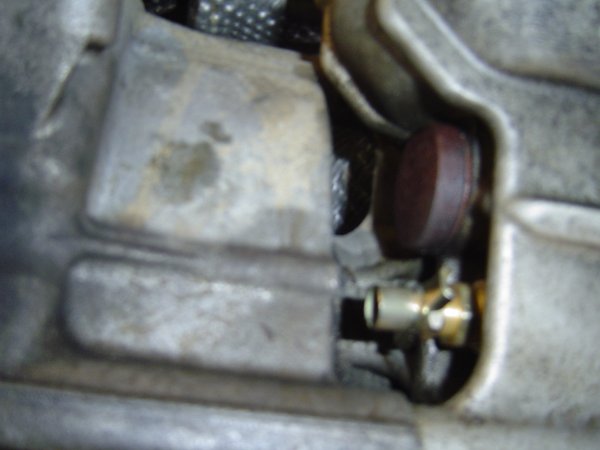

This is roughly what it is going to look like once you get it installed:
Not a lot of room, hence why I recommend only using the one adapter. But, you can get the tubing into the collar with the valve open (the valve slides into the transfer case when it is open).

Thanks for the pictures! Not exactly what I had pictured in my mind, but exactly what you described. A picture is worth a thousand words. Can you buy the radiator drain valve at an auto parts store or do you have to get it off of an old radiator? Do you use teflon tape at the joints? Someone refilled theirs with royal purple, since there is some fluid left in the transfer case is it compatible?

rjcl, when sealing up the valve, I would recommend using something with a good locking strength. Something like red Loc-tite is ideal. The reason why I say this is should you need to remove this valve in the future, you will be relying on the strength of the joint between the valve and the adapter. If the valve where to slide out and leave the adapter in place, then you will be forced to use something like an easy-out to get the adapter out then. Will teflon tape work. Of course. But, how much assurance do you want?
As for the valve, I bought it brand new at a local auto parts place (Pep Boys). You will probably need a larger store as the smaller ones do not seem to carry ones like what I picture.
