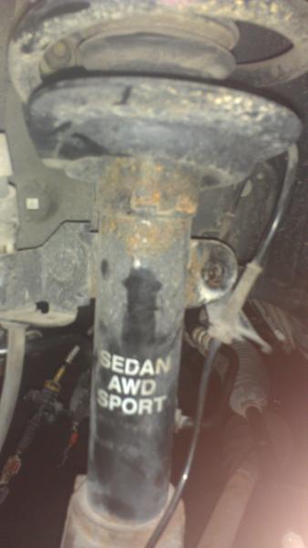

On the factory struts, if you can still read it, it will say 'SPORT' printed in big letters.
