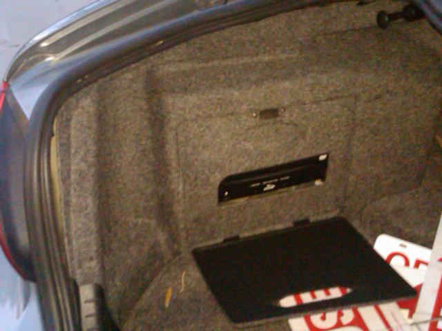

On my 2005 with Alpine premium sound, I believe the amp is on the driver's side wall of the trunk. It's also where the 6 disc CD changer would go if the car came with that option.

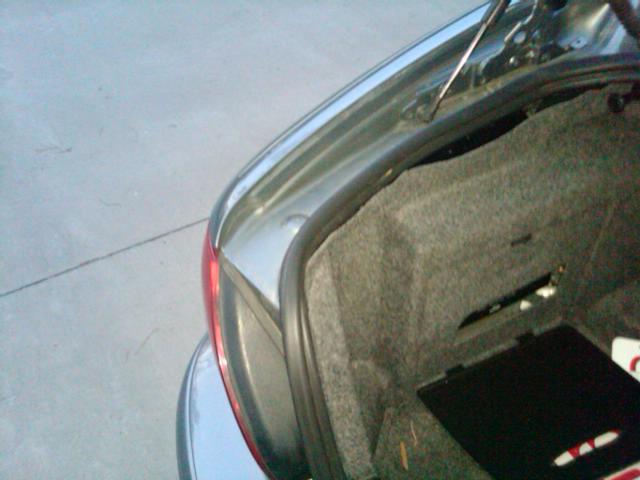

There is a flat casing under the rear deck, the speaker looking holes on the deck are from dual subwoofers. If you listen close you can hear the Bass but it's not a loud or strong bass thats why I added a ten inch sub. I have not looked for the amp, have NAV/CD changer in trunk.
