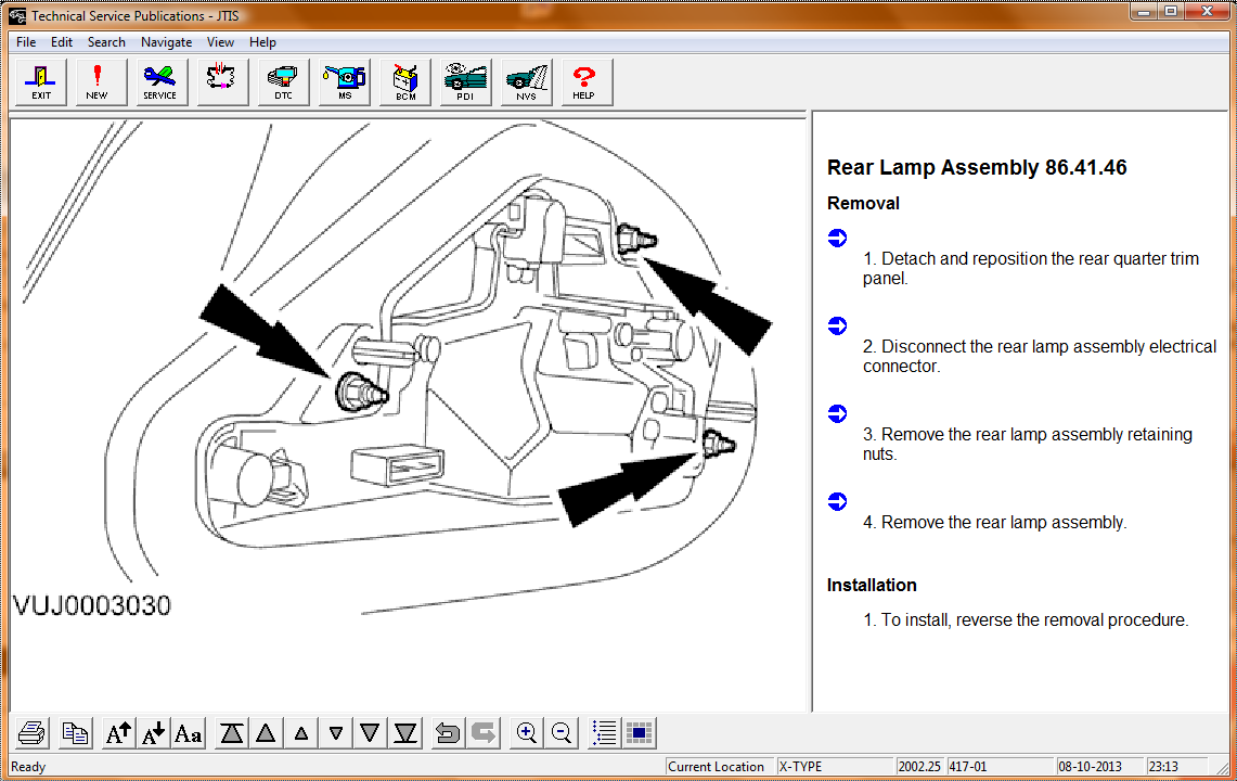

As for your issue. Are you saying that you have the complete tail light housing or do you just have the red lens and you need to attach the red lens to the black plastic backing? If you have the complete tail light assembly, then as clyons mentioned, you pull back the liner of the trunk, remove the nuts holding the housing in place, disconnect the connector and the tail light will fall right out.
