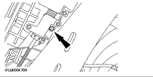

Can someone please post a pic of the RIGHT drain plug vs the WRONG Reverse Band bolt ?
Level plug
Drain Plug
Fill Plug
THIS IS THE REVERSE BAND BOLT!!!!! DON'T TAKE OUT
Transmission Fluid Level Check
WARNING:
VERIFY PROPER PLUG IS REMOVED FOR LEVEL CHECK.
Because of the similarity to other plugs and fasteners on the transmission, the potential for loosening an incorrect fastener, instead of the level plug, exists. There is a risk for internal transmission damage if the improper fastener is removed.
  • Removal of the reduction gear brake band bolt can cause total loss of drive or a substantial reduction in the performance of the transmission.
  • Removal of the parking pawl rod plate retaining bolt (located next to the XYZ switch) will result in problems/gear lever movement restrictions.

        Originally Posted by Norgards Automotive
        Level plug
        Drain Plug
        Fill Plug
        WARNING:
