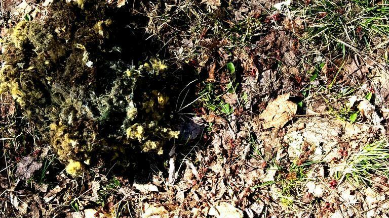

After my puzzling as brand new trouble code P0332, while I was looking for my manual yesterday, I discovered in horror that my glove compartment was super-full with massively crowded hard foam tiny crumbs. Completely full!. When I rose the hood I found that ALL my firewall insulation was missing. While I was dusting the glove compartment, the Mikey beast appeared and then disappeared behind the bunch of wires underneath. I couldn't catch it. Clarification that the brand new discovered P0332 is now explained by this massive mice activity by the wires in the area, not the Jaguar mechanics complicates my scare:
(1) What can happen now that my firewall does not have any insulation at all?
(2) How can I avoid this ferocious invasion for further damages?
(3) What is the black container appearing in the photo showing the empty firewall, that I found covered with some oil leak? (please tell me)
Can anybody give me some help here? Please. I am very upset as I've just paid almost $5000 for repairs.
AND WHERE CAN I FIND A FIREWALL INSULATION REPLACEMENT, PLEASE? I didn't find it anywhere.
