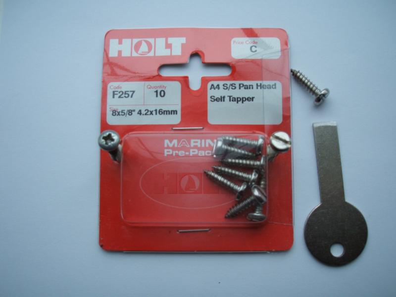

The key to the final part of the emergency boot (trunk) release modification.
My home made screw driver has been made by taking a a simple flat bladed steel ( no grooves) blank key and filing the end to fit the screws.
This now lives on my "house keys" key ring.
I certainly got some strange looks from the locksmith when I first asked for “a blank key” ( and no cutting required).

Re my earlier post
Re my number plate fixing screws. I need to swop the cross head self tapping screws for ones with a simple slot.
These will be easier to remove in an emergency. e.g. a manicure file.
I will look for something to attach to my house key ring for the task.
Task now completed.
I have found the perfect self taping screws and a simple blank key.
In the photo, the screw on the left is the original cross head and the pack contains, as the label says, stainless steel "Pan head" self tap screws.
The beauty of the screws is the large slot for easy access.
The key shaped screwdriver only needed a small amount of filing which was simple.
So the whole emergency access to the boot/trunk project is now totally completed and I have no more concerns about getting to the contents.
With the winter season it is even more important that I have access to my emergency kit.
I bought the screws in a boat spares shop for just over a UK pound.
The whole job cost so little and was so easy it still makes me smile.
Attached Thumbnails Is there a key hole to acces the trunk on a 2002 X-type-dscf4170.jpg
