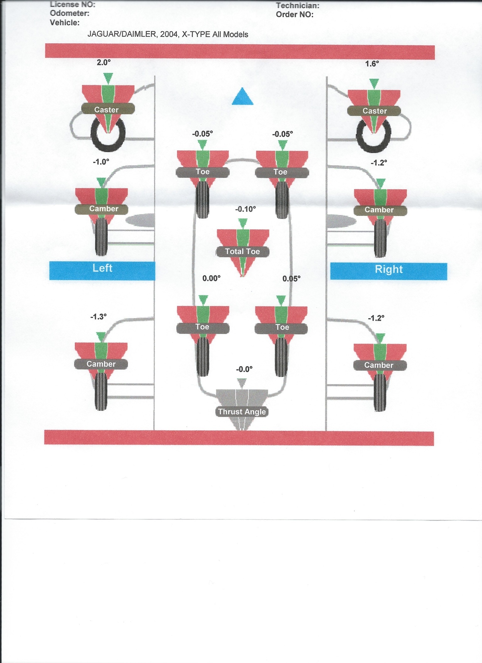

Default Here are pics of alignment
Originally Posted by Alfadude
Were they worn unevenly in the front or rear? If it is the rear and the tops of your tires are slanted in towards the inside of the car chances are the lower control arm bushings are worn and need to be replaced. Very common problem with our cars and is a relatively easy and inexpensive fix.
Here is the pre alignment result.

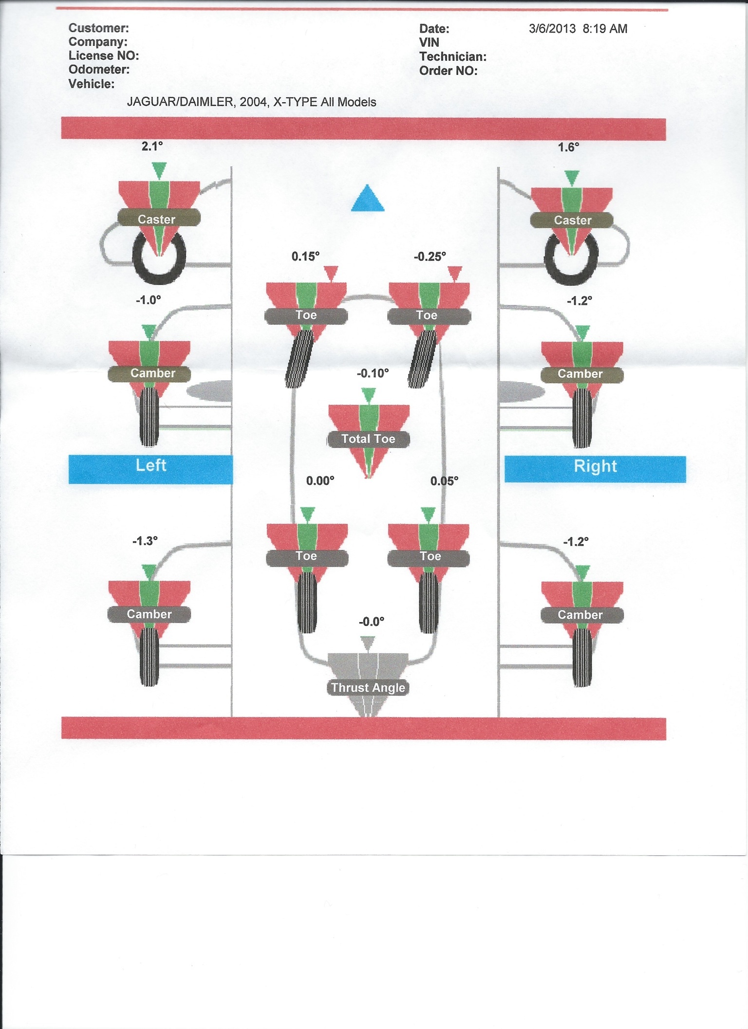

Here is the post alignment result

If the control arms were worn, could this cause a vibration at highway speeds?
Dennis
Old Mar 8, 2013 | 08:35 AM
Alfadude's Avatar
Joined: Feb 2009
Posts: 2,081
Likes: 304
I am far from an expert on the alignment specs, but if I understand the reports it looks like your toe in was off in the front and it looks like they fixed it, so you should be good to go. As for the worn bushing, I believe it could cause a little vibration, but you would feel that more in your seat as opposed to having a vibration in the steering wheel. If you felt a vibration with the old tires it also could have been that one or both of the front tires were out of balance. If it is driving great now with the new tires just relax and enjoy. I usually do an inspection of the tires when I wash my car just to make sure that if I see something unusual I can stay on top of it.
