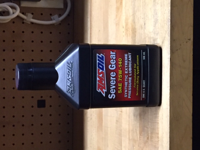

My choice for transfer case and differential in this new-to-me 2004 V6. Attempted to service both yesterday; what a PITA.

Sorry picture isn't upright. Not sure how to fix.
