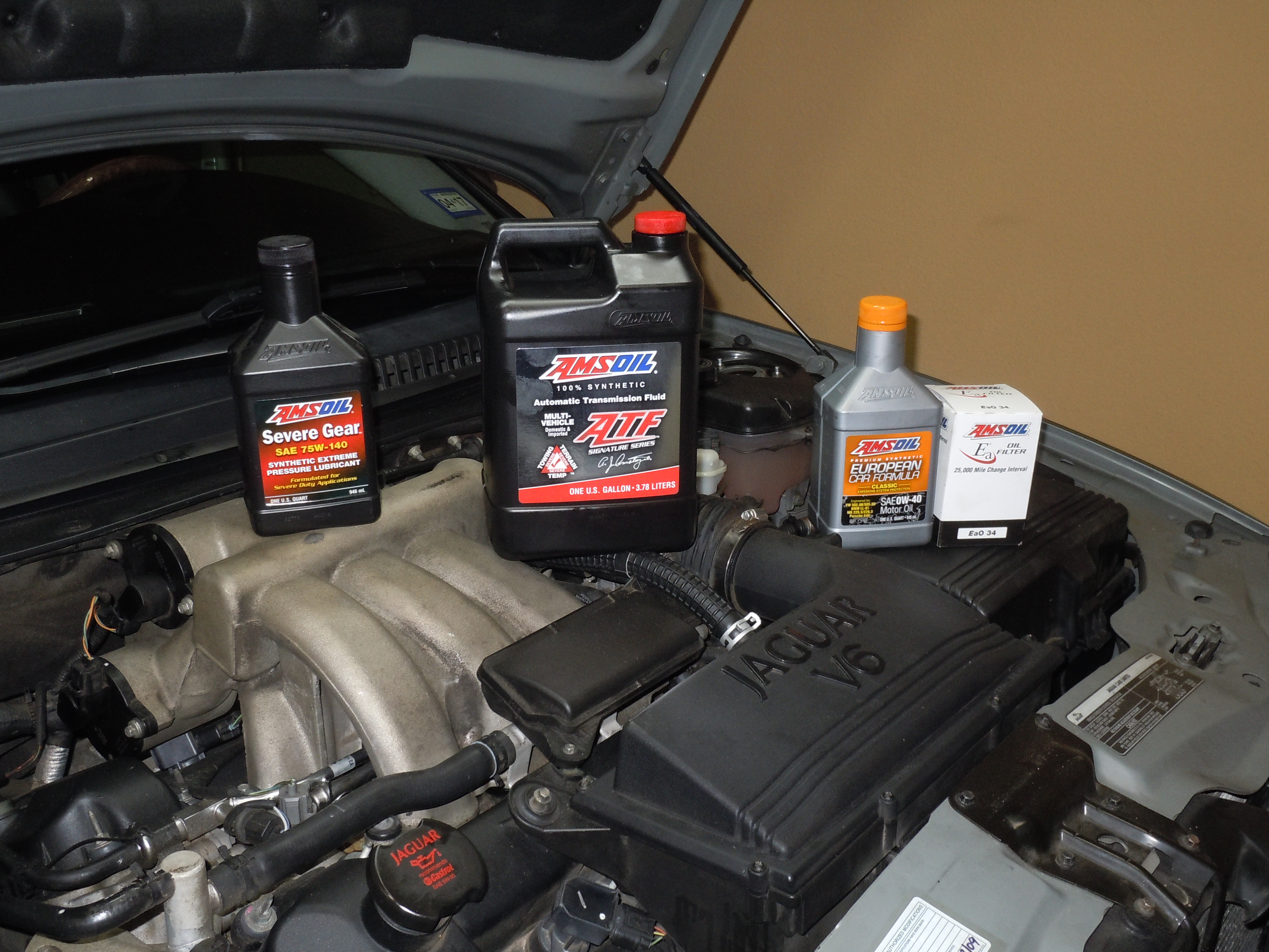

Yes, Jaguar said "lifetime fill" on transmission, transfer case and differential, as have many OEMs. However, many owners define "lifetime fill" to mean "lifetime fill until component failure, then we'll be happy to replace it - at your expense." I'm in that group. Drain your transmission fluid and you'll likely find two things: Low level and the fluid itself looks (and smells) absolutely shot. Transmission fluid drain/refill on this car is relatively easy; transfer case and differential lube change is more difficult but can be done if you have correct kit for DIY. If you don't wrench on your car then you'll need to hunt for a competent shop.
