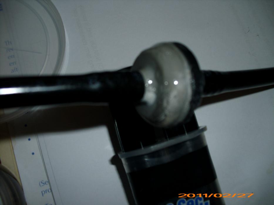

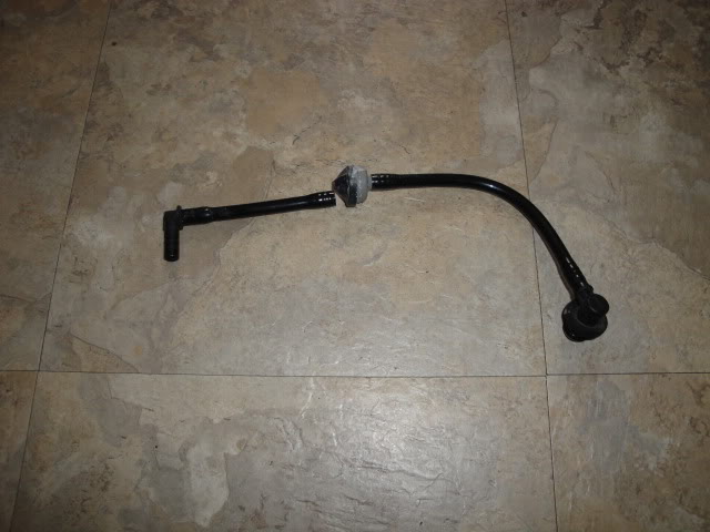

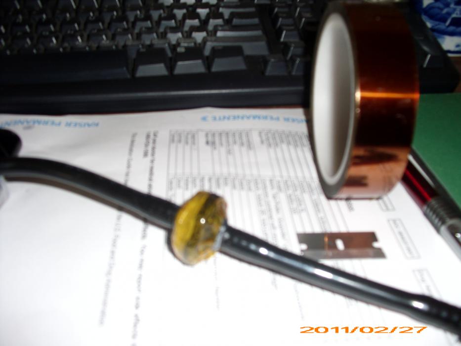

I got these 2 codes too for a year and couldn't fix it until I found the problem shown on the picture. the leaking part of the brake booster hose was on the back side. the whole brake booster line looks so new that I neglected any possible defect of it before. Then I sealed it with 60 second epory glue and high temp tape. now it works well and those 2 codes are gone.
2003 jaguar x-type 2.5L

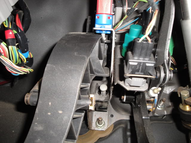

have you checked all these areas
you replaced the o rings below..what about the others
for the brake booster
one of theses plugs maybe disconected
if you have checked all these for vac leak
I have the same problem but Im going to fix it myself. Check my forum.

Thanks for the pics, I checked all but not those plugs. Where are them located ?

I got it they are by the driver side
