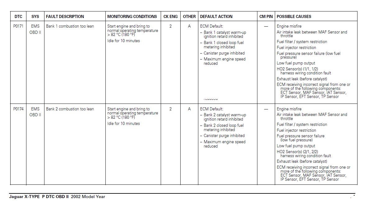

Originally Posted by furkin
................. I have come up with codes: P0171 & P0174 (plus 1111which doesn’t concern me now) & my mates also gets the No Cruise controllight....................
Here's the Jaguar DTC defaults and possible causes for P0171 and P0174:
As you probably know, P1111 indicates all OnBoard tests have been completed since the last memory clear.
