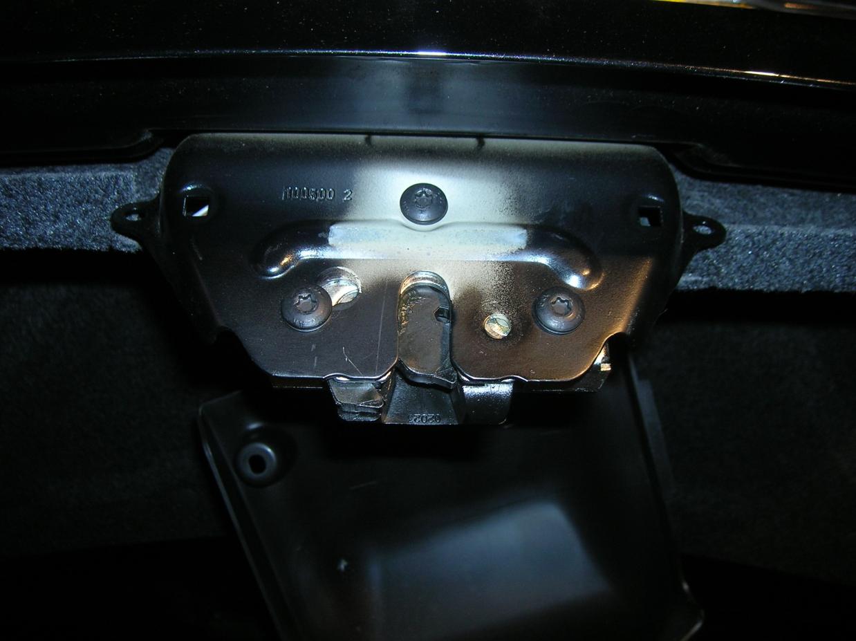

Real Tech - thanks for the great input. I'm pretty sure i've got the newer style - here's a pic of the latch. There are three screws holding it on and it looks like it used to be attached with just two.
As soon as I took the latch cover off it started working again. Any ideas of connections that would be affected by the cover? If it's from flex in the trunk hinge, how would i get to that part of the wiring?

That is the new style latch and you can see the original 2 holes where the factory latch was installed.
Though this is not related to your problem it may prove useful for other X-Type owners. Jaguar knew the latch was problematic early in 2002. They continued to install the problem latches at the factory until sometime in 2004. After about mid 2003 the latch plate came predrilled for both latch types but had the 2 screw latch installed at the factory. Just goes to show you how manufacturers think. They didn't want to waste the stock of the old style latches and figured that every one that remained in service without needing replacement was more money in their pocket.
Now back to your problem. The harness is in the right side hinge. You will need to remove the plastic hinge cover to access the harness. After the cover is removed being careful not to break it where the trunk strut pin goes through. You can either fold down the rear seats if you have that option and look from there or lay in the trunk while lowering the lid. You are looking for the exact point where the harness starts to fold into a V shape as the lid is lowered. Once the sharp bend area is found remove the tape from that area and see if the wires are damaged. If the wires are damaged here it is possible that just opening and closing the trunk can temporarily restore operation by forcing the damaged wires to resume contact. Repair damaged wires and try to secure the harness so that it flexes in a different area and not so sharply.
