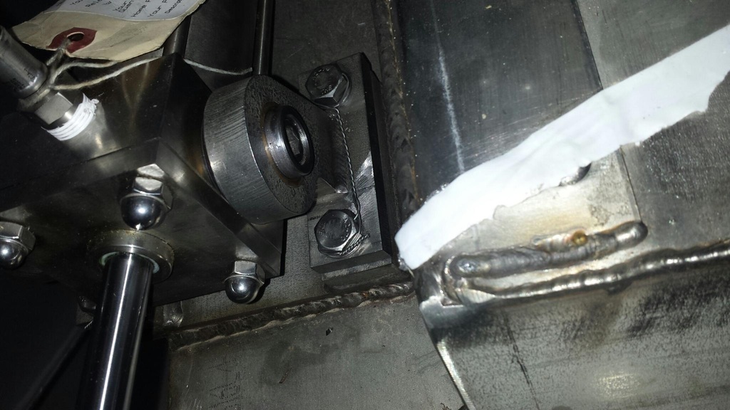

I can say with some authority that this job is not for the faint of heart. The most important thing to do he said was to grind a small taper on those bolts so they would find their holes easier. I think that's mentioned in Dick Maury's piece too.
The frustration was very thick at times, but I didn't hear any bad words I hadn't heard before. It takes a LOT of patience and tenacity, it's a slow job, but it Can be done by amateurs. It helped Enormously when he had the junker IRS out in the daylight to see for a pattern of how it should be.
As I mentioned, the major reason he had to do it this way was the welded exhaust system which we simply weren't prepared to deal with at the time. But really, he wanted to do it this way so he could say he did it.
Below is a picture of the wire I used and the tool. I'd never done anything like that before so I had no idea how to use the pliers. I'm sure it's one of those things, if you know, it's easy. Mostly I used them for their long reach into narrow places. For that alone they were indispensable. I never figured out the twisty thingy.
I wish you success.

go to any autoparts store and ask for "mechanic's safety wire".
Old Sep 2, 2015 | 06:57 PM
Posts: 121,178
Likes: 6,658
Those pliers are the bees knees for wires they should lock on the wire so that you don't need to hold it, then pull the silver knob in the centre and it should make a pretty twist. (this one is actually fixed to the wrong side of the bottom bolt)

I couldn't get the photo to come up, but there is a photo of the pliers on the O'Reilly's web site. Their safety wire is .032" diameter, and a friend who has done this job before and is going to help me Saturday said he used a heavier wire on his so perhaps the 041" will work. If not there is a parts store a block from the club shop so we should be good. I am picking up new pads at O'Reillys tomorrow so I'll ask if they loan or rent safety wire pliers and if not I'll make do with some extra long needle nose and flat nose pliers I have.

The wire I used is .041, annealed stainless steel.
Again, May it all go well for you. But even if it does (as it did here), you may still vow never to do it again. Husband has.

Actually, Carl, there is a Great difference between Baling Wire (.075 inches diameter) and Mechanics Wire (22 ga., .035 inches diameter).
See picture below:
I've included an American quarter for comparison.
Mechanics wire is sold on one pound rolls and galvanized to prevent rusting while baling wire (mild steel) has no such protection and is sold in 70 or 80 pound rolls. I suppose either would do in a pinch as safety wire but I wouldn't trust either of them with anything as seriously important as brake caliper bolts.
Annealed stainless steel safety wire of .041 diameter is easier to work with than baling wire and stronger than either mechanics wire or baling wire.
