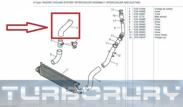

The one arrowed is the one most likely to split! On the bottom one the hose clip onto the intercooler rusts through, and the hose pops off! get silicone ones are above.
