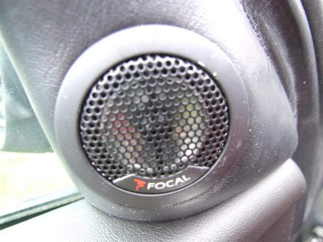

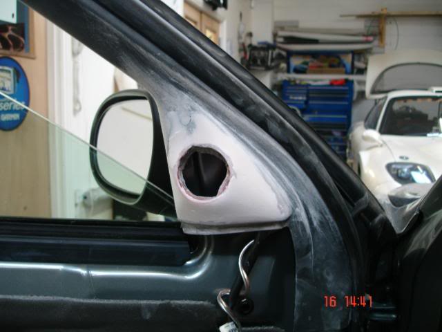

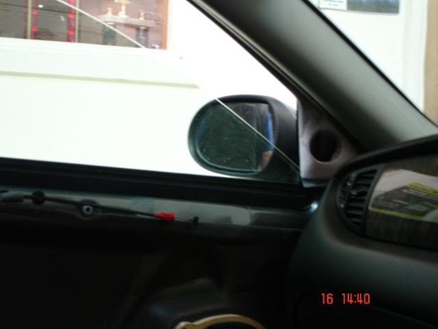

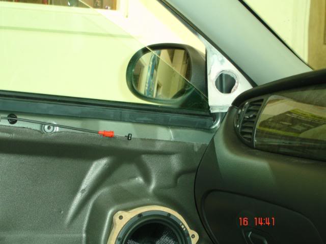

I forgot you did that buck...yeah that is what I was trying to talk him into doing! Did you watch them do it buck? Was it too hard to glass that in?

BuckMR2, that looks awesome. I bet that sounds incredible. Wish I had fiberglass skills. Thanks for posting those pictures. There isn't a whole lot of custom stereo shops where I live so I doubt very much anyone around here has the skill to pull that off. After seeing your pictures though I am going to check around.

No I didnt watch them do the fibreglass as they had the car in their shop for a few days but they were good enough to take pics every step of the way.
I found the amp makes a BIG difference to the volume...like listening to your CDs on an old walkman to being there live in concert!! and the Focal speakers mean the volume can be heard crisply and clearly at all levels right up to 35 with no distortion.The positioning of the speakers helps with the depth of the sound.
