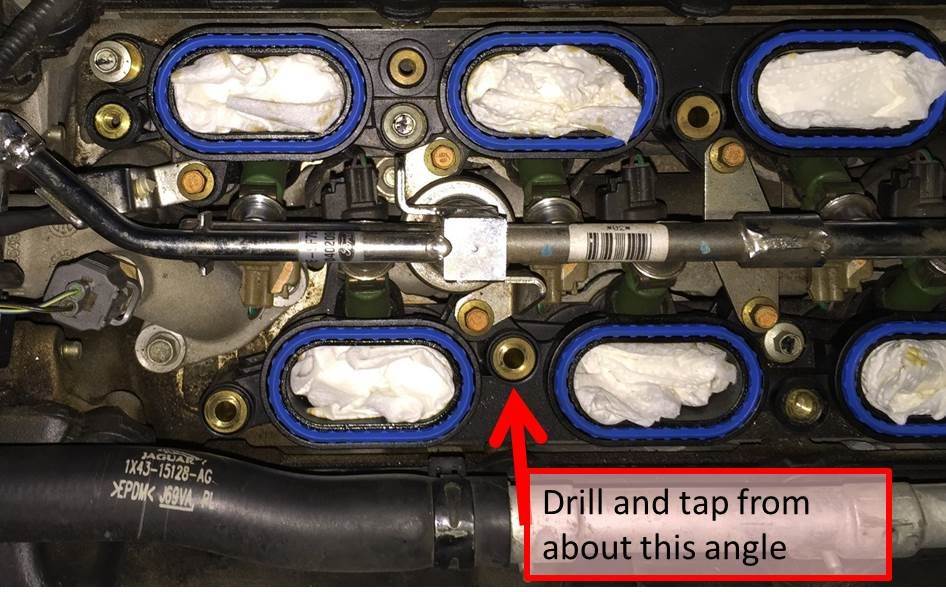

I had the same problem. I was able to get a small drill bit in from the front of the car, drilled through the plastic and a little bit into the brass insert, then used a bottoming tap to put some threads in there. It was small so maybe a 4-40 or 6-32 thread. Then I threaded a set screw in that hole I had just made. It held enough for me to get the bolt out without cutting the head off. Once the upper manifold was out I took that lower manifold out and carefully drilled more into the brass insert/nut so the set screw had more "bite". Then with the lower on my workbench, out of the car, I put another set screw in on the other side. Due to the geometry I wasn't able to get them exactly opposite, maybe 150 degrees apart and not 180. I have since removed the upper from the lower at least 5 times without an issue. I did thread lock the set screws in because I was worried they might shake loose over time.
Below is not my picture, it was taken from a different thread on this forum and I added the text, but I would point out you want those intakes covered up so you don't drop anything in there.
