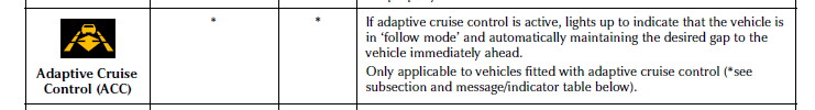

My 2002 Jaguar XJR has an interesting light on the dash, to the left of the orange TCS light. Its a picture of a car, with two arrows behind it facing front and back. I can not figure out what it is, and I have NEVER seen it go off. I also can not find it in my manual. Any ideas?

Look like this???

This is exactly what it is! I knew thats what it was, but my car does not have the ACC, so I thought it had to be something else. Well, thank you, and where did you find that picture and description?

I actually got it from the 2001-2002 XK8 Owner Handbook. The XKR could have had ACC, the XJ [X308] never did. Since the instruments were shared it only was described in the XK Handbook.
