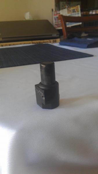

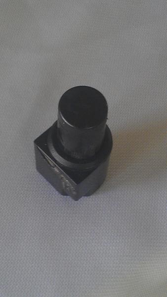

Did a better search and found out that they are the rear trunk bumpers. Don't know where the brackets that were part of them went. Guess they have been broken for a long time. If anyone has a photo of how they are supposed to attach that would be nice.
Also anyone know the part number? I looked at our sponsor's parts page but couldn't tell if I had the right one or not.

Part number is C2S024715 from X Type parts list

Trunk lid is where that part goes. On both corners of the lid hinges
