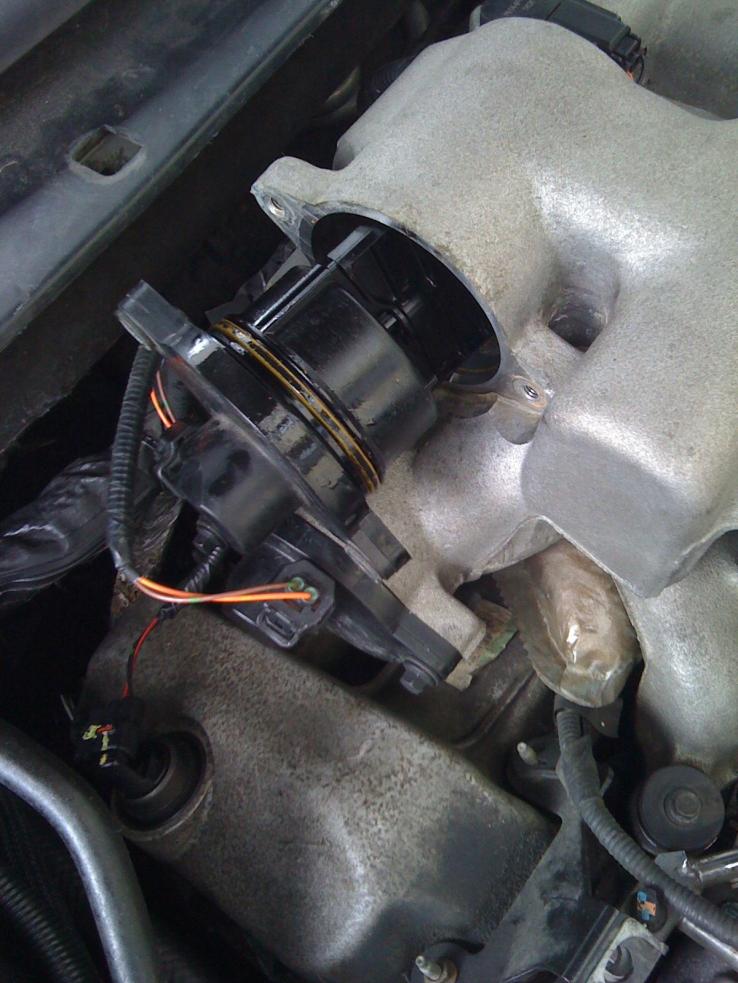

Hello,
what is the name of this part and did this gasket looks used and is ready to change?
Thanks for Help.

That is the upper air intake tuning valve. The O-rings cost like $8 each, but as you can see are easy to change. Should be able to pick them up at any auto parts store.

this o-ring looks defect or?
Here are two air intake tuning valves, the upper one is simply to change, the down one is i think only possible to change when i removed the intake manifold or?

whit what i have to clean the tuning valves when i change the o rings?

what country are you in? your english is a little difficult to understand.
can you explain what you are up to? why do you have the IMT ports open? was there a problem to begin with?

im seating in Israel.
a leak is the problem, i hear air from there. Now i want to change the o rings.
the lower tuning valve o ring is the problem, is it only possible to change when i remove the intake manifold or?
and my second quastion is, which cleanser i have to use when i put the new o rings?

Shalom!, I am supposed to visit Israel later this year. My best friend is an Israeli living in Canada.
To clean your IMT unit, just wipe with a cloth, no special cleaner is needed. It already looks nice and clean there. You can fit a new oring on the lower unit without removing it completely. Just pull it out part way and unplug the wires, then you can stretch the oring on from the outside.
If you get the new orings from the dealer the issue should be fixed for a long time.

i must the new o rings to anoint?
