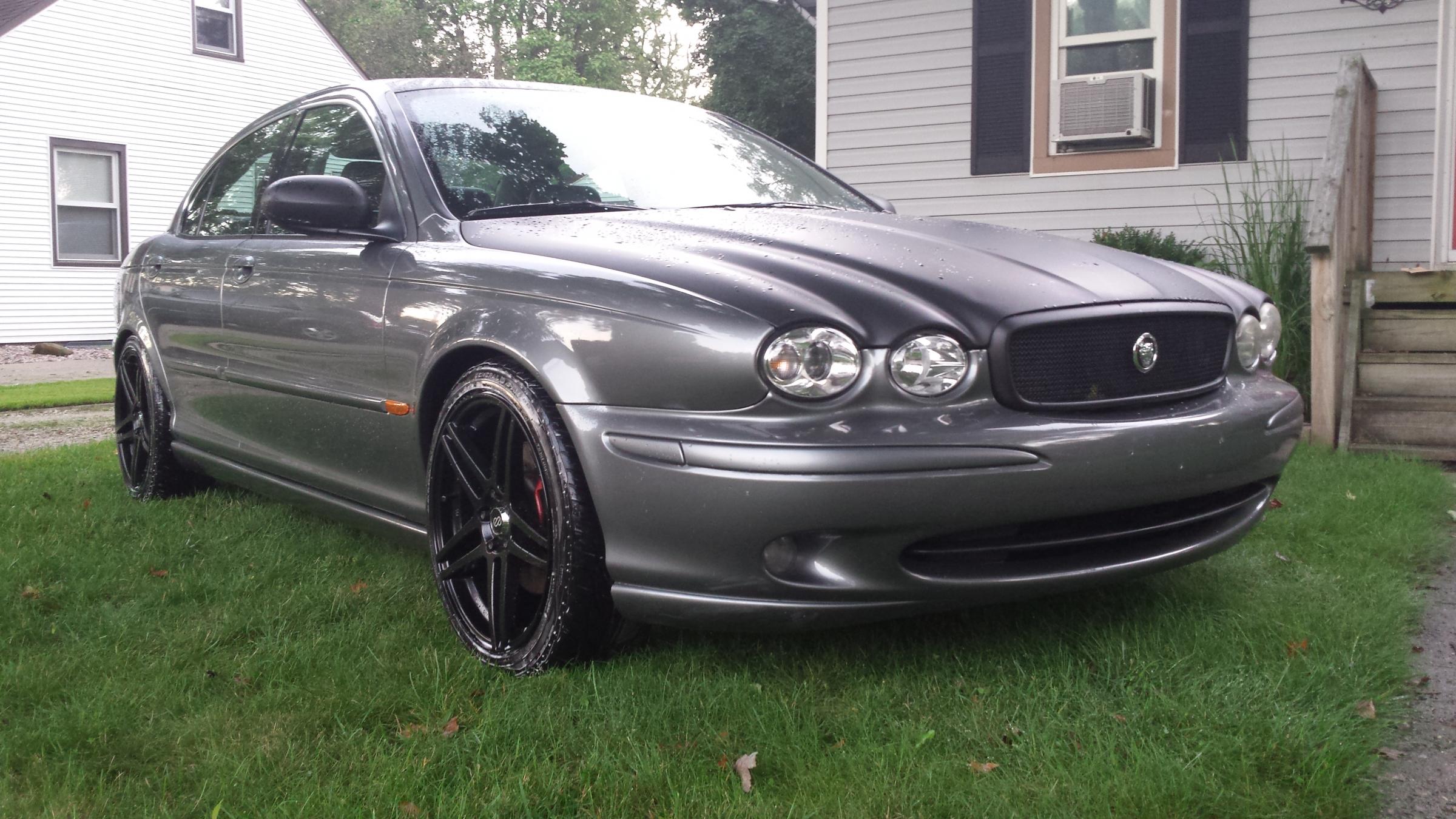

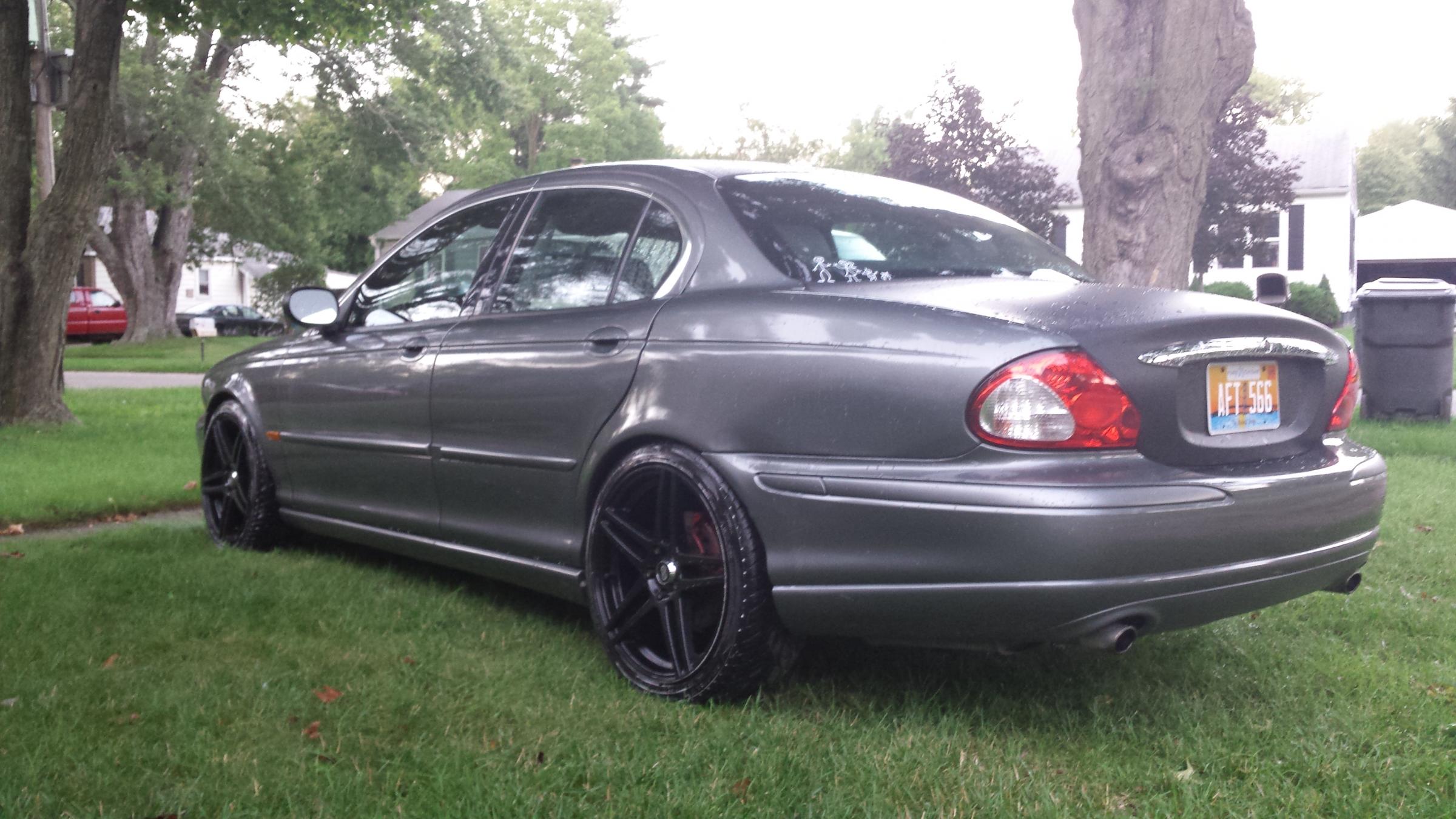

This is an 8 inch wheel with a 40mm offset on my X. With a 7 inch wheel and 40mm you're looking at 13mm or half inch more clearance on the inside and It'll set the lip of the wheel back/into the center of vehicle the same difference. Might want to throw some spacers on there if you like the more flush look but 40mm is a good offset.
I think the center bore is 63.4. Not really relevant as most aftermarket suppliers include bore centering rings that adapt their large center bore to your specific size.
Attached Thumbnails Wheel size question-20140902_200842.jpg   Wheel size question-20140902_200951.jpg
