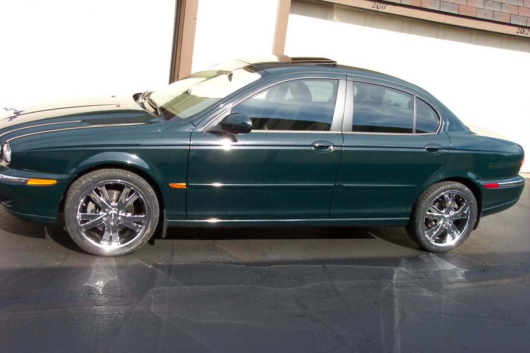

how low are we talking? The 17" konigs on my car now have a 35 series profile. How low are we talking i'd want to go with on an 18" or 19"? I wish I had the stock aguilla's on mine but these konigs are growing on me. What size rim offset and all do I need. I've heard that some gms have a similar bolt pattern and offset. If this is true my buddy bought a set of 18x9's saleen wheels for his century. What width in inches will allow an 18" rim to fit on these x-types. Whats the max. Wondering if I could go with a 18x9 and 18x10 in the back! Just wondering though...
i run 225/40/18 with no changes to the suspension and no problems.
i still need to snap a new picture. the wheels in tis are clean, but the tires had a bit of residue from being mounted, nor does this show the painted cilver calipers.
There are 20" wheels on this X type:-[sm=yikesomg.gif]
Supercharged X Type with 20" wheels
I read your link to that a while ago...Didn't it say something about the alteration to the car to fit them? That is a sweet car though. My tires are series 45 not 35 like I originally stated. Does anyone know what offset the rims need to fit?
offset is like 45 i think...45-48 some way off not normal number.......that's why only a certain few rims will fit correctly.
