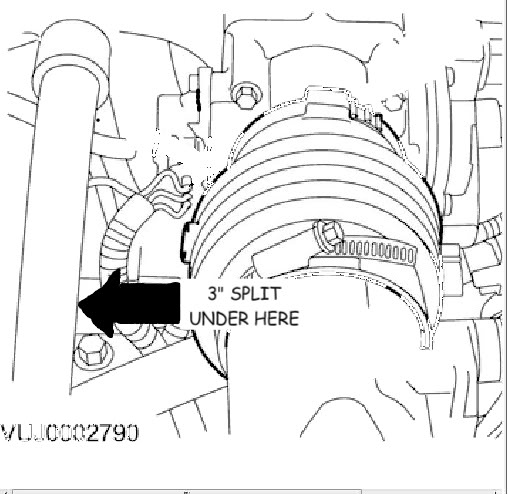

It might not be this but it only takes a minute to check.
Remove the engine cover (3 screws).
Check under the 7" air pipe that goes from the rocker cover to the inlet manifold.
These have a tendancy to split (mine did the other week) and the rough running, intermittent 3000rpm limit and terrible mpg werer cured.
Cost £5.30 for a new pipe.

yes , you were right ! I had also a little hole in the tube. I fixed it temporarly. It seemes to be better , also the engine light went off after some miles. Thanks for the nice drawing. I willl do some testdrives ;-)

Hi Buck,
I am new to this forum. I just bought a 2007 X Type, 3.0 AWD and am having the same problem. The engine revs normally when in P but when I am accelerating or cruising the engine stutters every once in a while. Then the check engine light came on. I tried following your instructions on checking the pipe for a hole but I am not sure that I am looking at the right pipe. On my engine it seems to be a rubber hose. Here is a picture of the engine and I am talking about the black hose on the left. Is that what I should be checking?

That is the correct hose to check. However, the one you have is the newer version of the hose that is much stronger, so probably not the cause of your issue. Best thing is to have the codes read and post them here or do a search of the code numbers. I'm sure you can get to the bottom of your issue and get your car back to running normal again.
Thanks Buck, I was ready to take it to the Jag dealer and get raped. The easiest fix ever and cheapest. My car no longer hesitates, stutters at 1500 -> 2000 rpm. Runs like a dream again and no engine light. Is this a great Forum or what !!!!!
