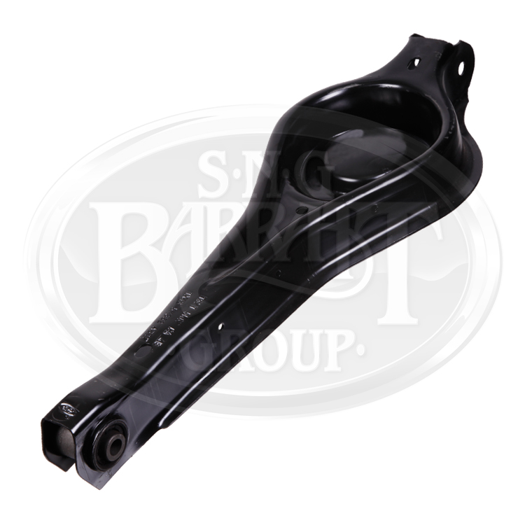

Hi guys it's the lower arms that house the rear springs

Sorry - I uncovered a typo in the printed SNG Barratt catalog. Part number is C2S24713. Part is same on both sides. I'd check with this forum's sponsors to get them. I also recommend you purchase new fasteners as well. The old ones ain't coming out easy I'll tell ya. Livingston where, by the way Kdog?

C2S24713 Sorry this is not compatible fir 2.5v6 awd:-(

Yes guys that is the correct part no ,,and I see what you mean those eccentric bolts don't come out ,,good job the kit I bought has them ,,thanks guys
