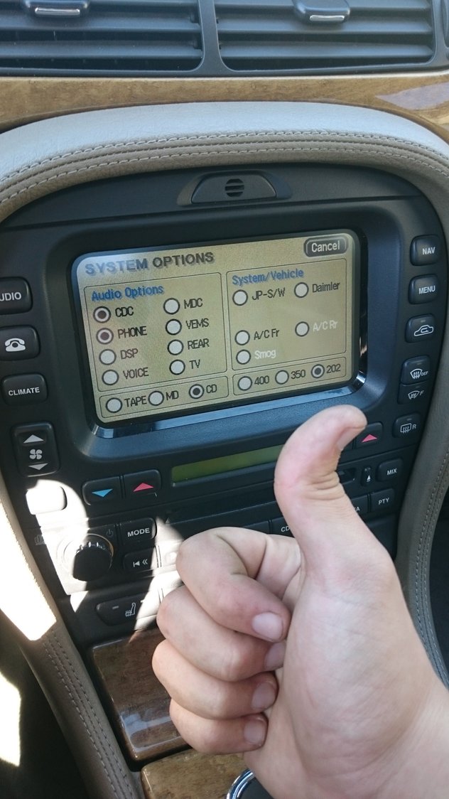

So, I bought my 06 Xtype with 10 speaker stereo and Bluetooth phone and no nav. I added a CD Changer and then added jaguar voice. Each time you add a component it has to be added to the fiber optic line.

Many thanks good chaps! I've managed to bring the CDC to life!
