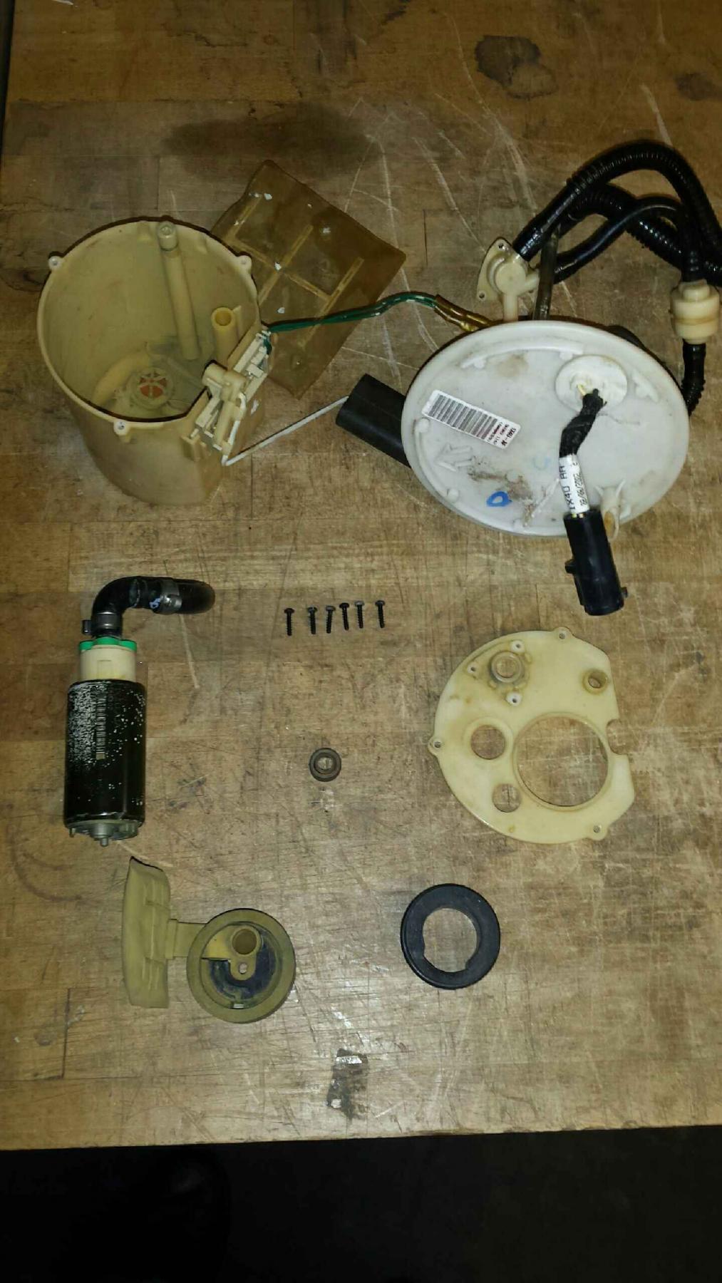

All, Be careful of sparks near the gas tank while cutting! I did go thru the trouble of removing the tank. I even ordered a new one from E-bay, but the picture of the pump was not what I received. I ended up taking the fuel pump apart and replacing the pump motor itself. It is not very complicated, just requires a LOT of patience. The hose clamps on the pump assy can be loosened enough to remove with a screwdriver. Carefully remove the 5 or 6 top screws and take off lid. Be careful to remember where all pieces go for reassembly! I will attach pictures to help.
P.S. Dr. Dome was also very helpful with a lot of parts and info!
Attached Thumbnails X-Type Fuel Pump replacement-disassembled-pump.jpg   X-Type Fuel Pump replacement-disassembled-pump2.jpeg   X-Type Fuel Pump replacement-disassembled-pump3.jpg   X-Type Fuel Pump replacement-pump-hoses.jpeg   X-Type Fuel Pump replacement-pump-hoses2.jpeg
X-Type Fuel Pump replacement-pump-hoses3.jpeg   X-Type Fuel Pump replacement-pump-motor.jpg   X-Type Fuel Pump replacement-pump-motor2.jpeg   X-Type Fuel Pump replacement-pump-part-number.jpeg
