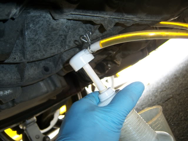

just remember it will last along time as long as you dont treat it like a drag car.....no launching ....but i must stress have your transfer case fluid changed ...i have a write up
also your transmision oil ...basically start of fresh so you no everthing is done and then you can calculate when the next time for a fluid change ....
