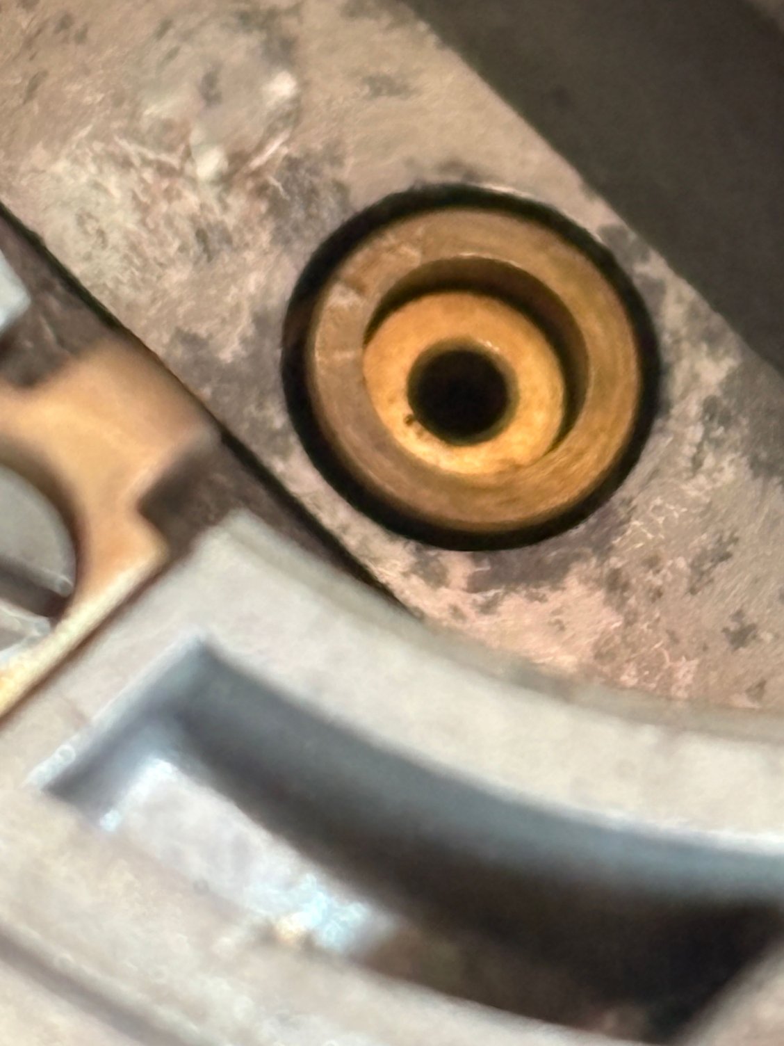

here’s a photo of how the jet was sitting, I’ve since adjusted it to be flush with the collar?
Jet on the front carb

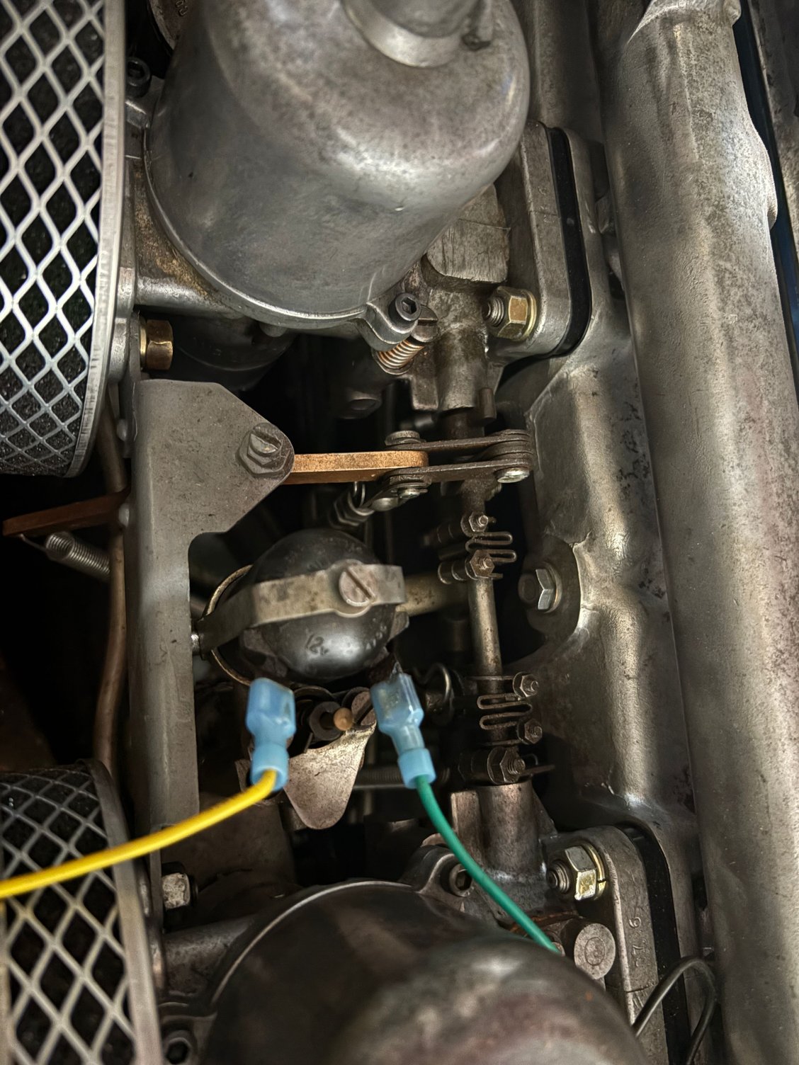

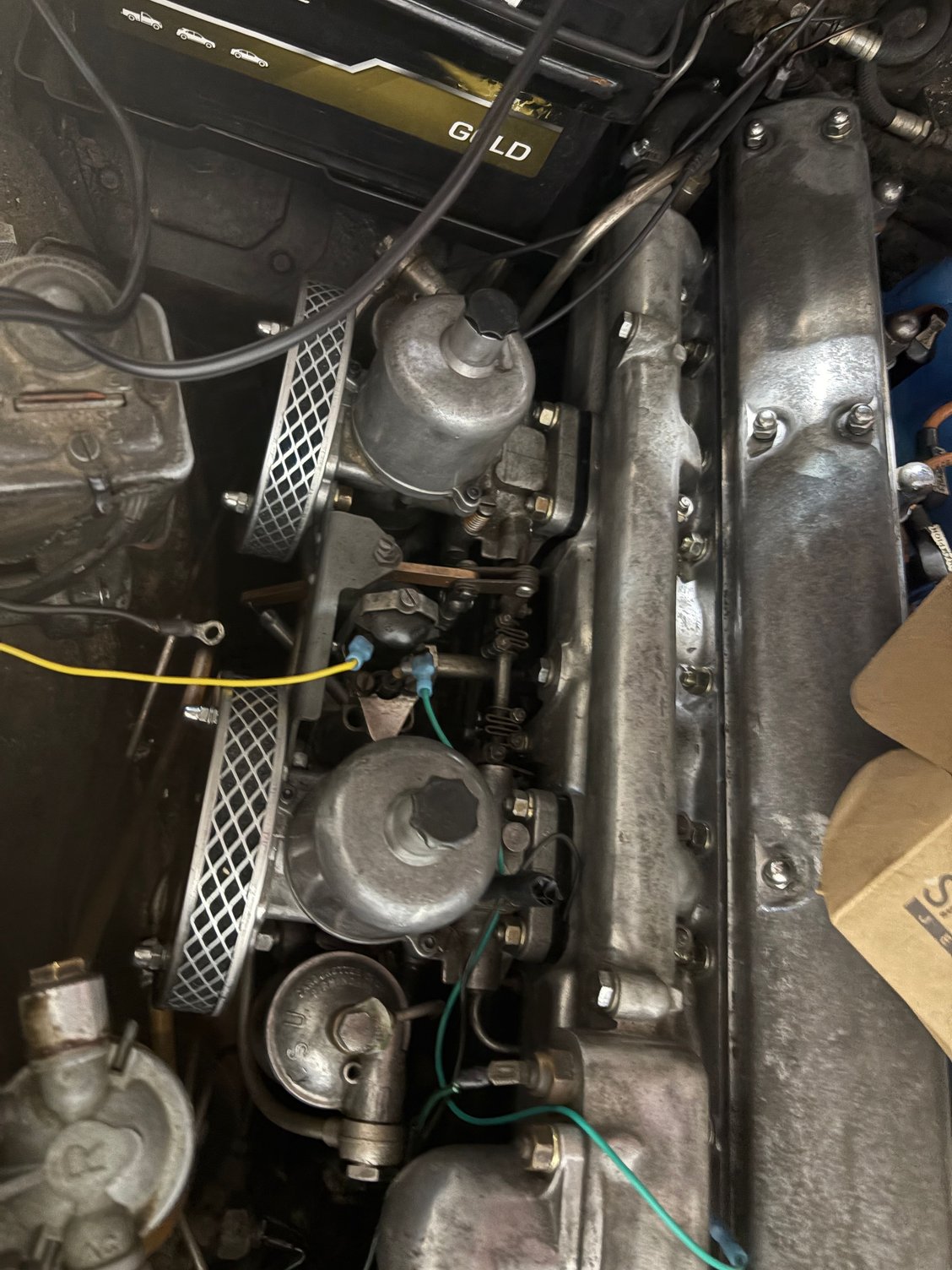

Aux carb
Aux carb
Pair of SU HD6
Pair of SU HD6

Yes! The jet needs to be flush with the collar as a starting point for adjustment.

That photo is showing the jet set extremely rich, it is not level with the jet bridge, I doubt if the car would even run with it like that, it would be flooding.

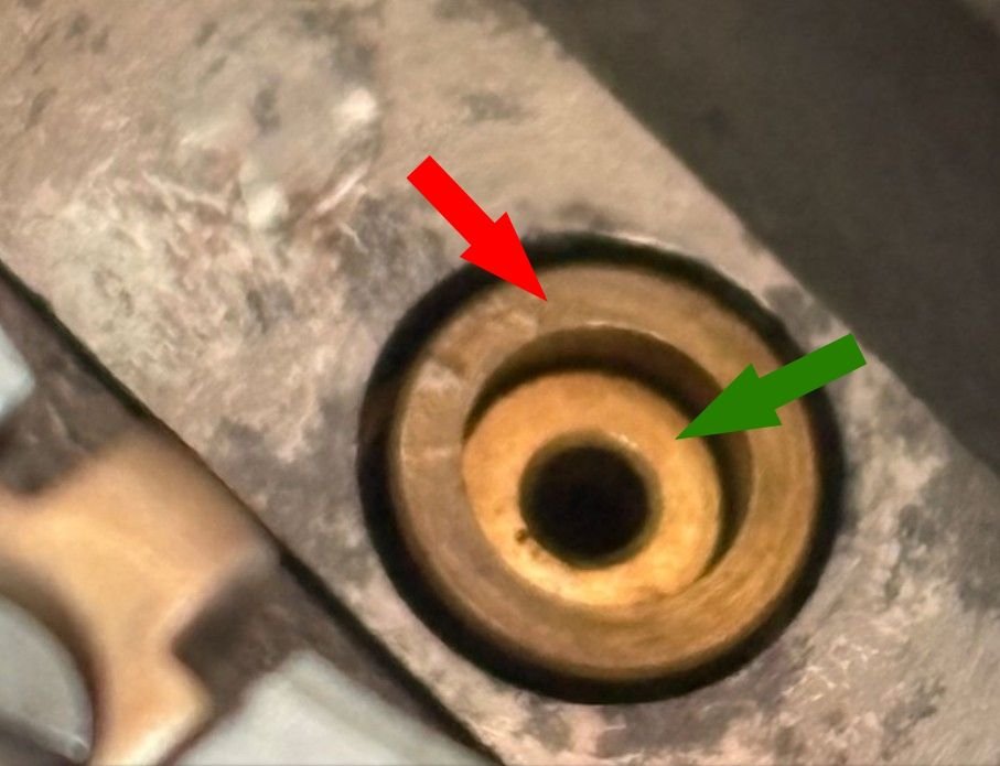

It's supposed to be flush with the jet bridge initially, but then you turn in the "richness" screw 1.5 turns for the first start up. (doing this from memory, but I think it's 1.5 turns, check the manual and confirm that)
If the jet is level with the bridge, it's now too lean and the car will not start.
Red arrow is the jet bridge and the green arrow is the jet.

Leave your mixture where it is for now at 1.5 turns.
To set the idle and balance the carbs:
Loosen off the small screw (green arrow), that will essentially disconnect the butterfly valves from each other.
One will be closed all the way (the one closest to the front) _ it has the return spring, the rear carb will be free to open and close.
Remove the dash pot on the front carb and make sure the lower linkage allows the butterfly valve to be close all the way with the return spring, if not adjust the linkage. (it's a collet fitting)
Remove the dash pot on the rear carb and gently hold the butterfly valve shut with your hand, and snug up the nut (green arrow).
At this point, both butterfly valves should be held shut with the return spring on the front carb _ install the dash pots.
Gently screw in both idle screws (red arrow) until lightly seated, DO NOT TIGHTEN THESES, just until lightly seated _ very important.
Back them both out 3.5 turns for initial set up.
These screws also sets the balance and idle, so your setting the idle and balancing the carbs at the same time.
This procedure must only be done with engine fully warmed up and both butterfly valves must be shut.
