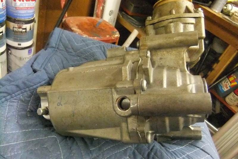

JK, I have my old transfer case from my 02 that I removed many moons ago. It has the bad inner seals. In the years since it's removal I have on occasion toyed around with it and attempted to prove out drainage techniques and get to those "inner" seals. They are encased in a heavy gear housing with several heavy duty rivets holding the two pieces together. This is a VERY MAJOR component of your drive train and much skill, finesse and caution are required to remove, install and or repair. In my simple opinion, currently, this is the MOST difficult tedious component in the entire car. I would rather chase down electrical gremlins than have to deal with the TC.
Just for you, I went into the garage this morning and dismantled my old TC I keep around, just in case they discover a way to successfully thaw out the cryo frozen people and come up with a way to deal with this particular element of this vehicle, and I took some pictures for you in order to make you fully aware of what you will be getting into. So here they are:
Transfer Case by James Fenley | Photobucket
Some of the photos are from the Haines TC project

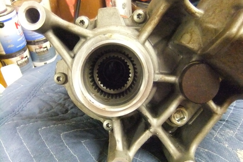

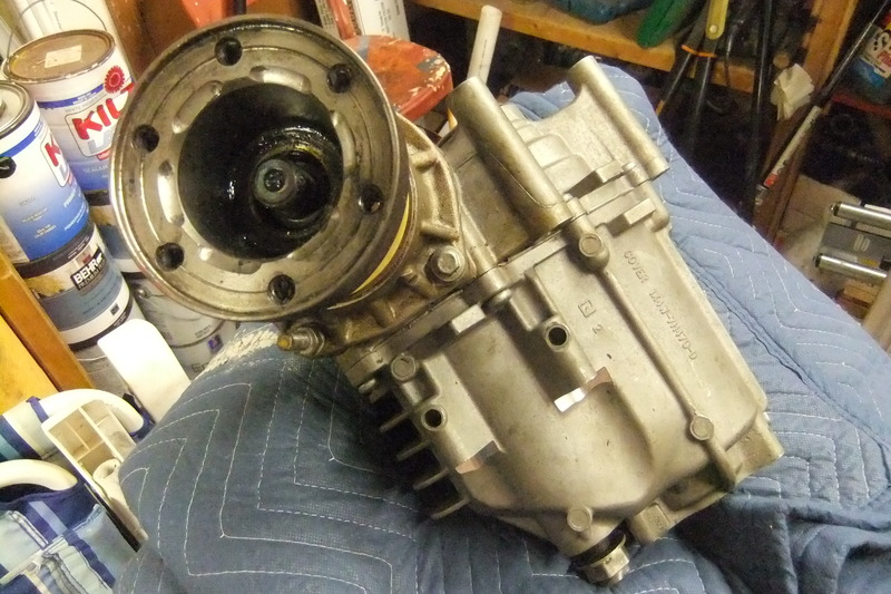

I present you with this to start. After you successfully remove the TC ( my entire sub-frame and wheels where removed to gain easy access and little frustration and more comfortable working conditions) from the vehicle
Size:  150.9 KB Name:  DSCF0880.jpg

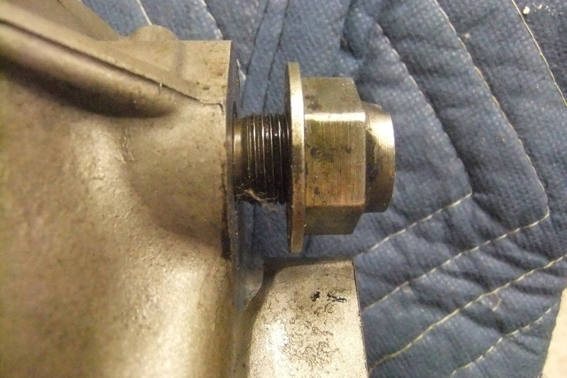

Now lets' open it up...note the torx screws, they are on this side of the 2 piece main body of the case and on the opposite side.

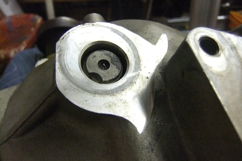

Once you have successfully removed the Torx bolts holding the casing together you will need to release the pre-load/guide shaft nut on the housing.
Size:  137.2 KB Name:  DSCF0884.jpg

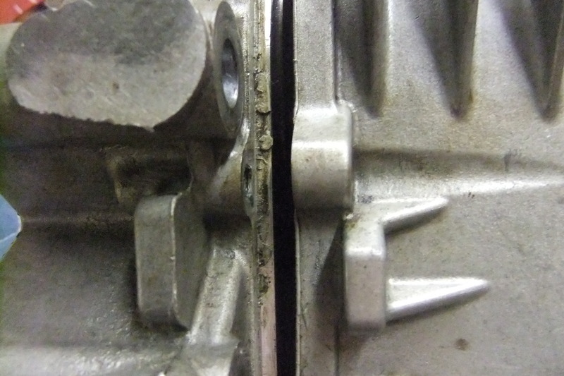

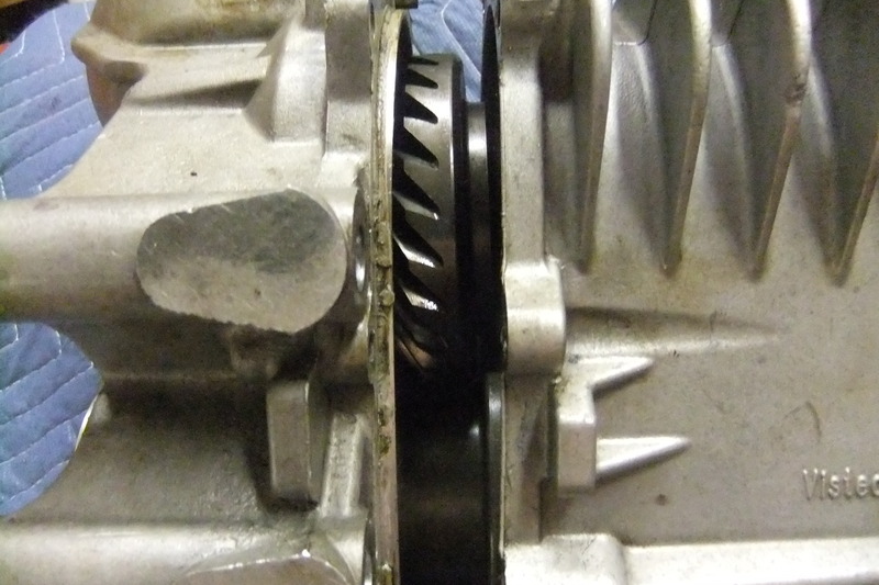

Now you have to separate the case pieces, Not Easy! I recommend some heat, not soo much that you melt rubber but enough to soften the seal compound holding the case together. You will definitely need a mallet. DO NOT PRY on the gap the begins to open, you could gouge or mar the sealing surfaces.
Size:  126.4 KB Name:  DSCF0886.jpg
Size:  124.6 KB Name:  DSCF0887.jpg
Size:  147.5 KB Name:  DSCF0888.jpg

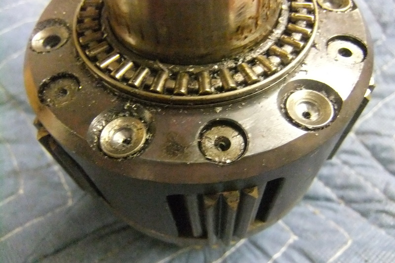

So now you have the pieces beginning to separate, notice on the large section that the per-load/alignment shaft is beginning to go inside case. BE extra gentile and careful as you slide the case off. There is ALOT of WEIGHT on the inner section of gears and you are about to remove the one thing that keeps them stable and in position.
Size:  154.0 KB Name:  DSCF0890.jpg

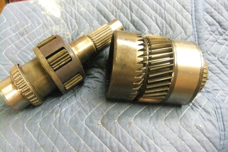

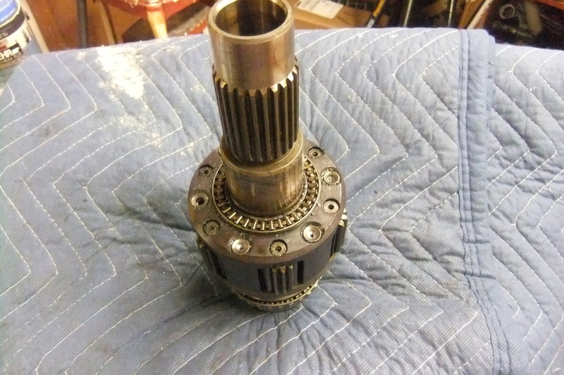

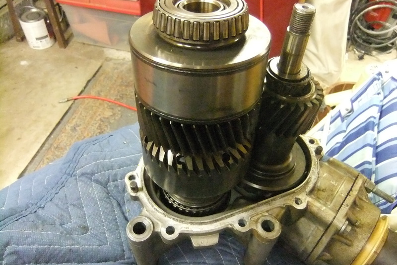

Are you ready? lift out the large synchronies section: CAUTION! It is not one piece, it is actually 3 pieces stacked on top of one another with meshing gears.
Size:  156.1 KB Name:  DSCF0894.jpg

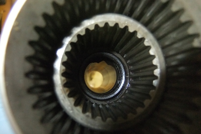

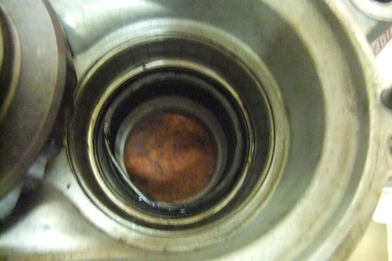

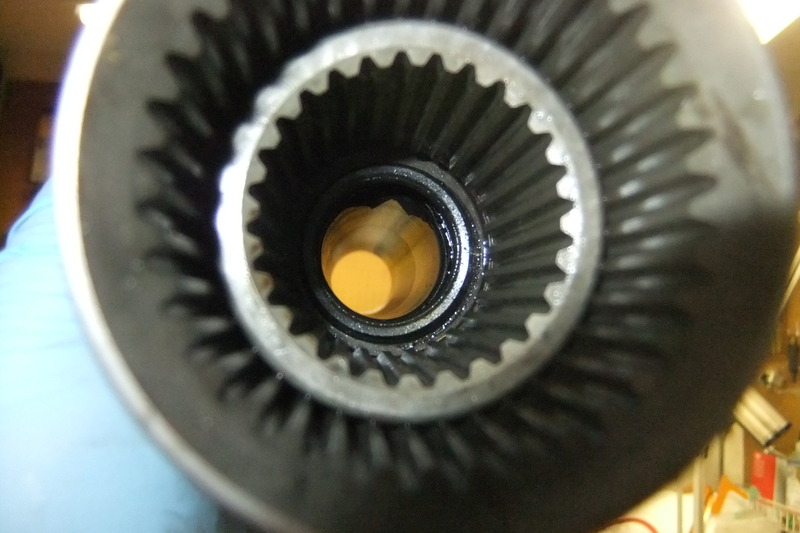

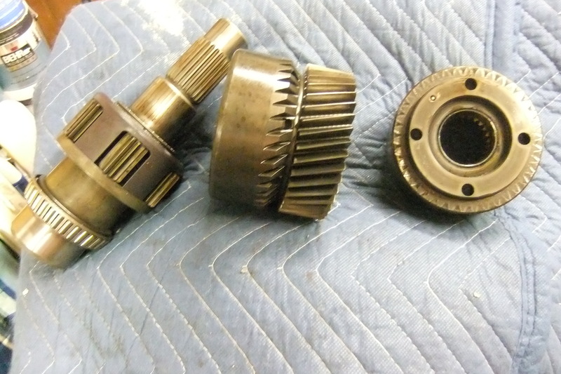

Are you ready? Here is the prize. The seals are inside this syncro housing. In the past I wanted to get to those seals so I attempter to remove the hardware holding the housing together. After a bit, I decide against the idea. I did not want to DESTROY the housing forever, so I abandoned the idea. Maybe someday there will be an answer.
Size:  137.3 KB Name:  DSCF0896.jpg
Oh yes, those inner seals. They are buried inside the housing.
Size:  102.6 KB Name:  DSCF0899.jpg
Now that you can see the scope of getting to those "inner shaft seals" I hope you realize the tremendous task involved in attempting to replace those seals.
