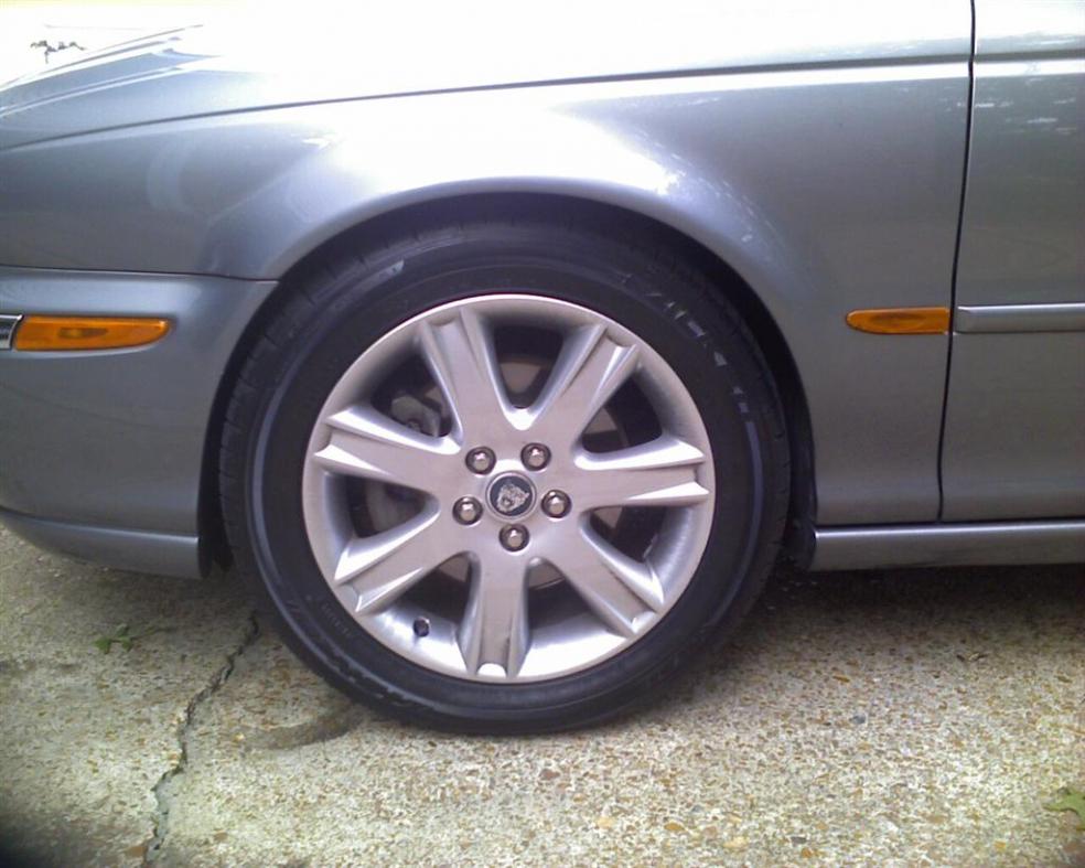

Okay, here's the outcome. After puting on the Falcon 225/50-17 tires and doing an all wheel alignment my car is driving like a dream, and QUIET too. Unbelievable what a difference it made. I love it when I do something that you notice an immediate benefit. And it was not expensive. Here's a link to the tires I bought (bought them locally for $110 each plus $44 for wheel balance & valve stems. They did the alignment for $59 since I paid to have the wheels balanced just a few days ago. I am also including the alignment results below.
http://www.discounttiredirect.com/di...w=false&cs=225

Hey RickMG those 225/50/17 you had no rubbing with those or any issue?
Old Aug 10, 2009 | 05:34 PM
RickMG's Avatar
Posts: 87
From: Ballwin, MO
Not that I've noticed. I would think if I was going over a big bump while turning it might hit, don't know. Actually, I think they look better than before, as the other's almost looked to small for the car.
